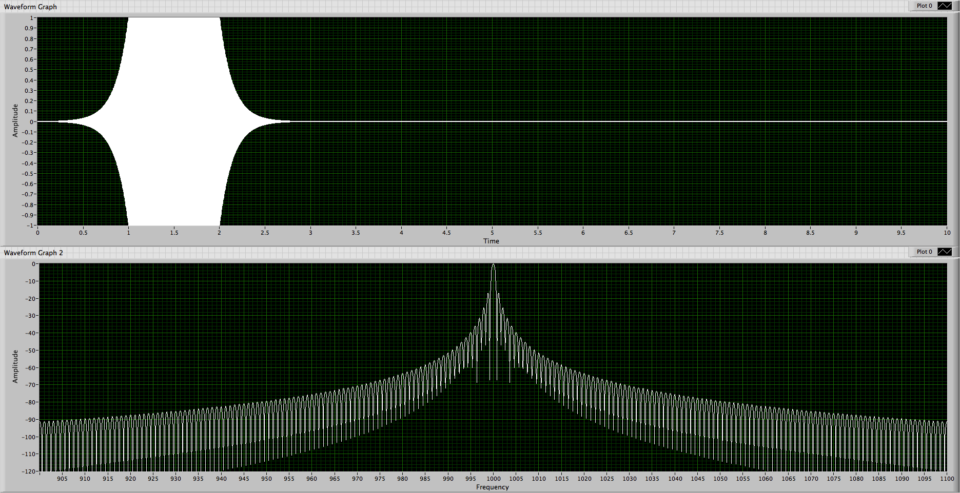

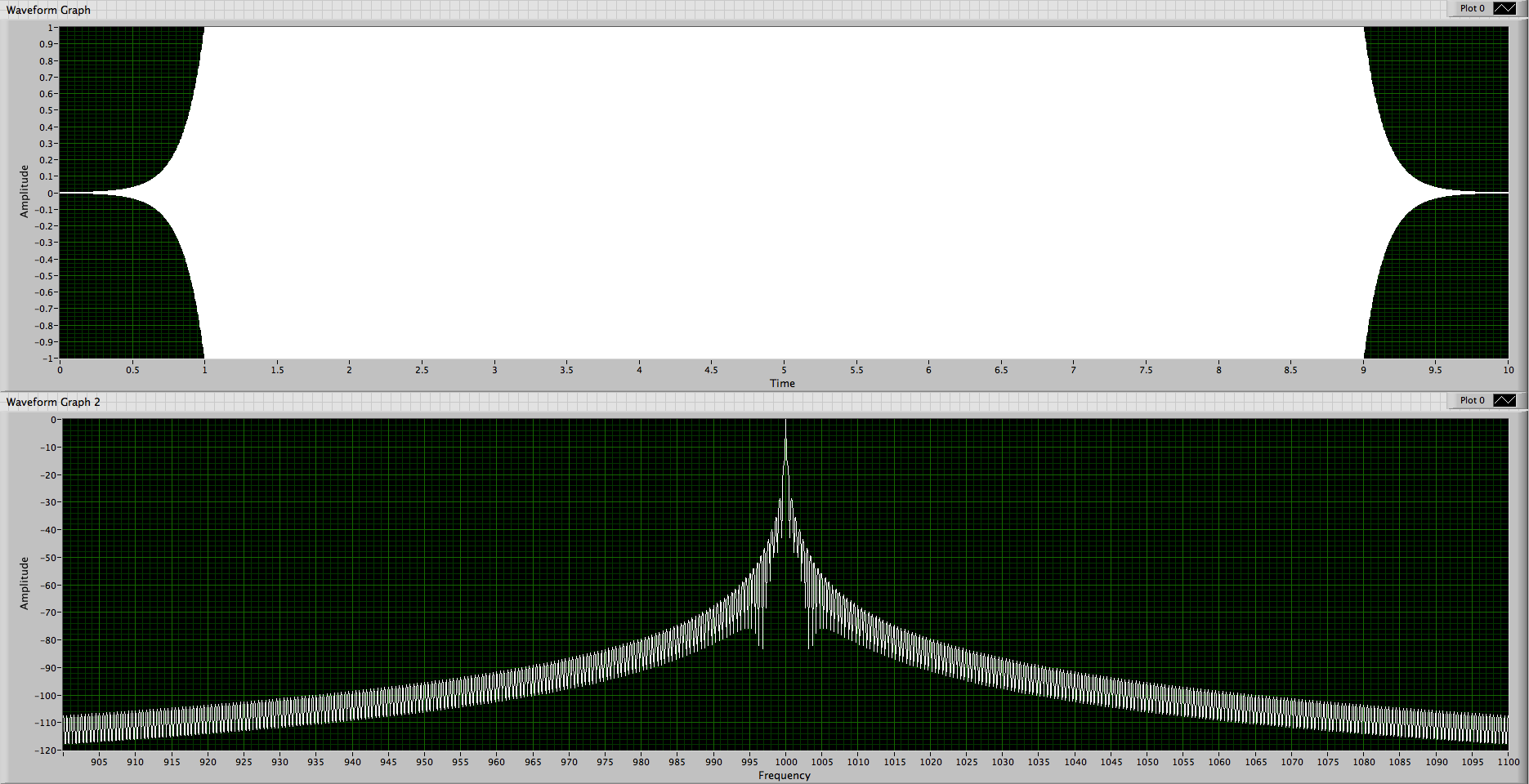

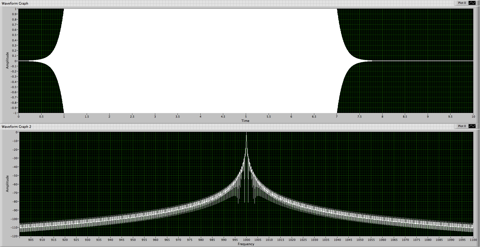

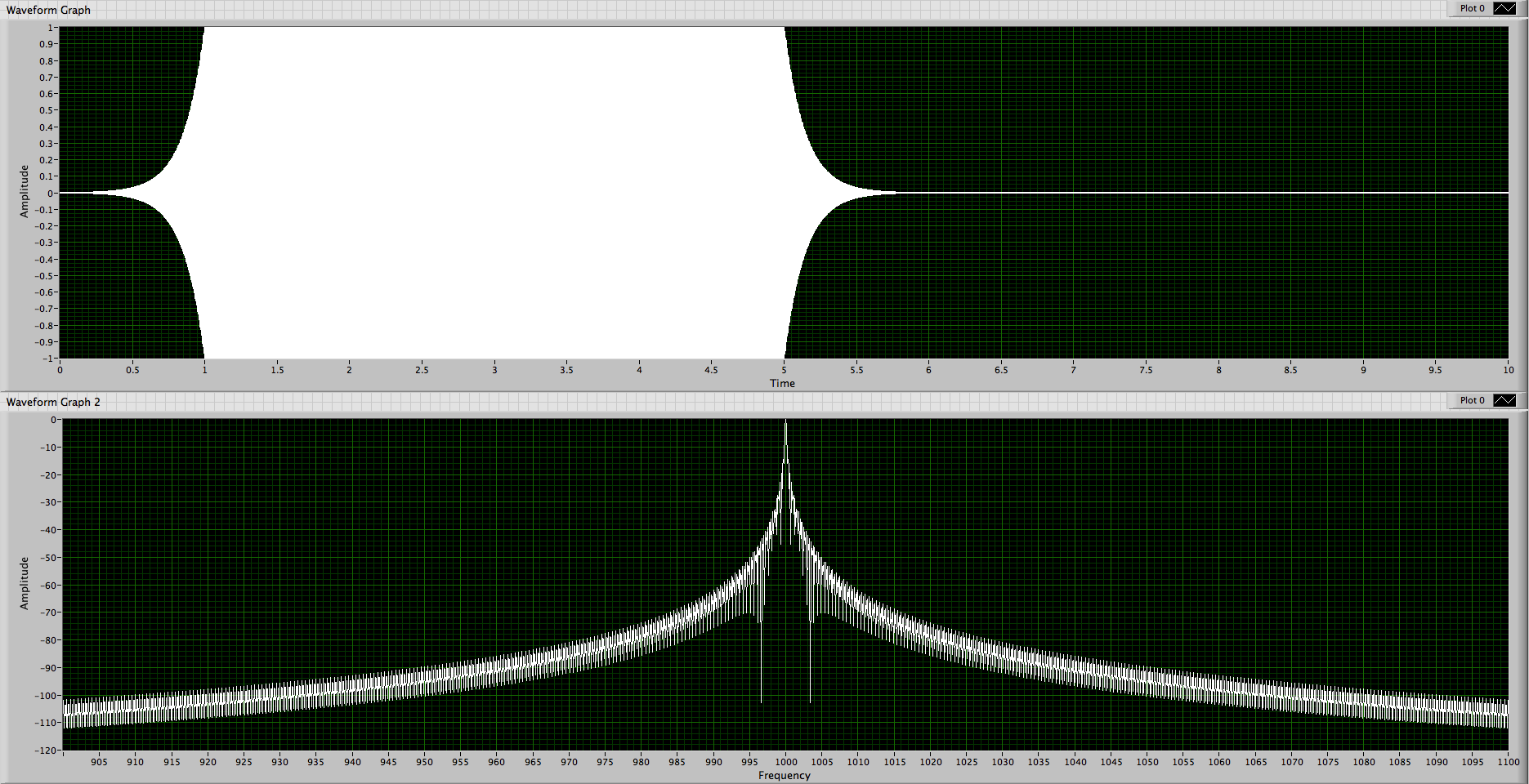

Ok, thanks for reinforcing what I already know, I am interested in rough amplitudes of such sidebands.
The answer is... it depends on all the details you left out.
I made a few plots... if you want exact numbers, give me details and I'll send the numbers.
My laziness and assumptions: 1kHz. 10 sec record. Linear rise and fall from/to -60dB - 0dB in 1s. 8, 6, 4 and 1 second at 0dB, plus the rise and fall; the rest is at -60dB. Values normalized to 1 in time domain, 0dB in frequency domain.
Questions? Just ask...
