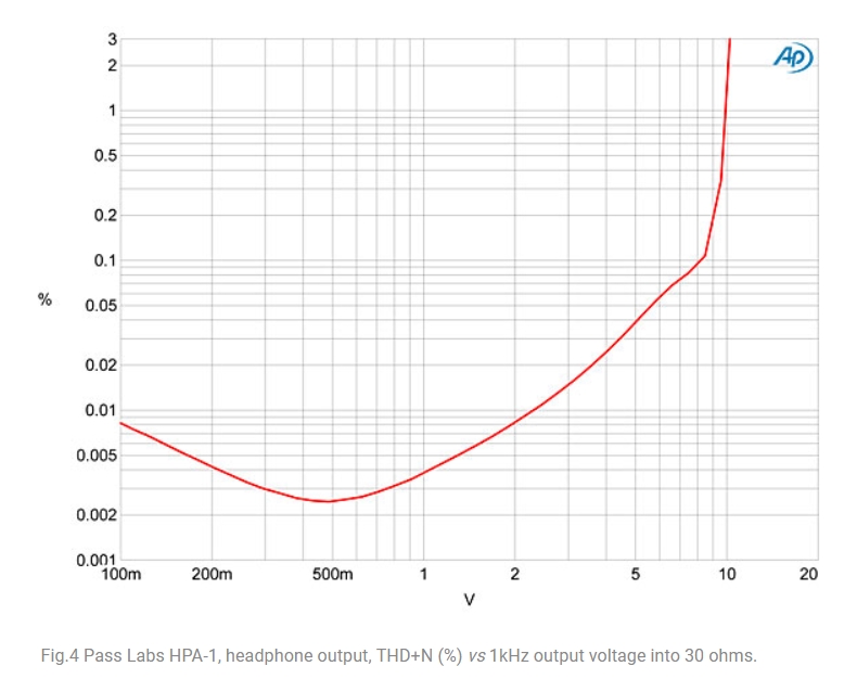

They commented it had better behavior in clipping, but none detected the compression until it was well into action. Our hearing mechanism similarly becomes increasingly non-linear as volume increases so compression is a normal attribute of listening at higher levels.
True. Please take a look at the distortion curve for Pass HPA-1 shown at: Pass Labs HPA-1 headphone amplifier Measurements | Stereophile.com
It's another approach to doing something similar, 'dial-a-distortion' to taste one might say. No accident its that way, IMHO.
