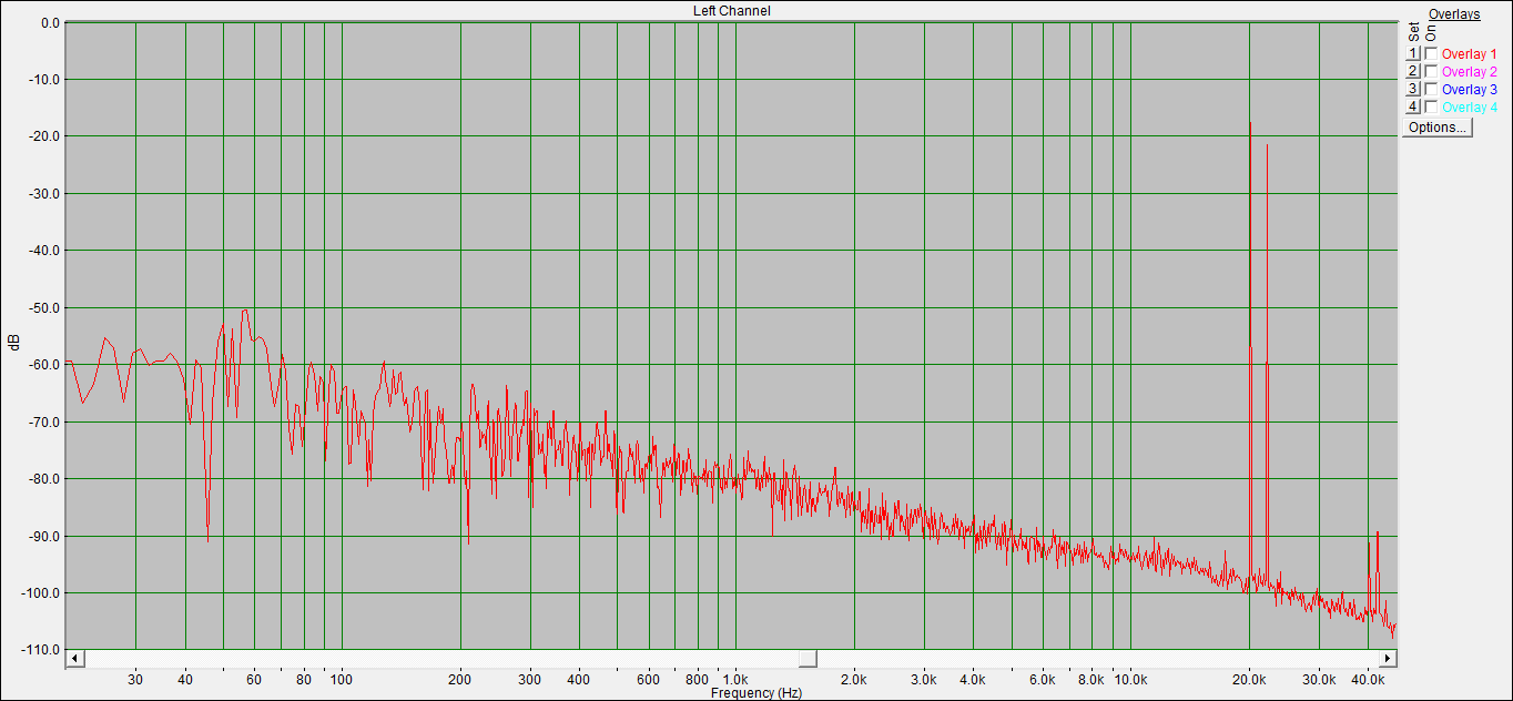

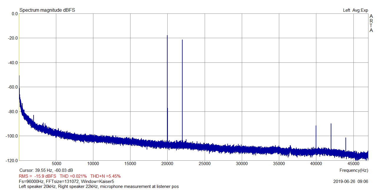

Anyone can try
http://pmacura.cz/13+14k.zip
(13kHz L, 14kHz R)
http://pmacura.cz/20+22k.zip
(20kHz L, 22kHz R)
Beware of level!!
Left channel is one frequency, right channel second.
I can hear 13/14kHz test, but no intermodulation. I hear nothing from 20/22kHz.
Again, take care about volume - your tweeters are in danger.
This is how the 20+22kHz signal reproduced from 2 speakers looks like (left chan 20kHz, right chan 22kHz) at listeners position. Measured by a microphone. There are no LF intermodulations on acoustical side. And I hear exactly nothing. Also please note quite negligible distortion components at 40, 42 and 44kHz, that are more than 60dB below fundamental frequencies.
How about running the ultrasound simultaneously with music signal and see/hear if the ultrasound 'modifies' the tonality of the music.
Please feel free to participate in the test
Can you hear sound above 21kHz? - listening test
The test file has a real sound content above 21kHz.
Anyway, we always must be sure we do not hear driver intermodulation instead of ultrasound effect.
