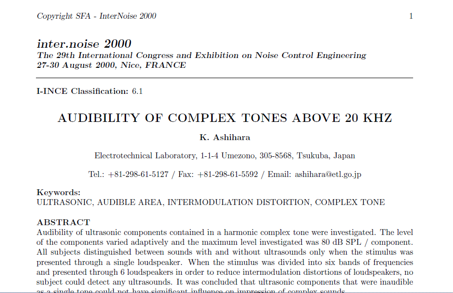

And here's a reminder, for Jakob and everybody who would like to follow on this:
Oohashi reported in Jakob's much beloved 2000 paper the results of experiments that he claimed are proving people can perceive ultrasonic sounds, thus confirming for both audiophiles and sellers of “high definition” products that CD quality audio is crap. Oohashi did an (unintentional, I guess, although the convenient (for the "high end audio" aficionados) conclusion could make someone believe otherwise) fatal mistake: he used only one loudspeaker to play multiple ultrasounds at once. The inherent intermodulation distortion in the tweeter created products that are well in the audible range. The Oohashi experiment was repeated years later by Kiryu and Ashihara using separate loudspeakers, and as a result none of the test subjects were able to distinguish the ultrasounds. A random quote from their work:
When the stimulus was divided into six bands of frequencies and presented through six loudspeakers in order to reduce intermodulation distortions, no subject could detect any ultrasounds. It was concluded that addition of ultrasounds might affect sound impression by means of some nonlinear interaction that might occur in the loudspeakers.
I believe it is now clear why the Oohashi study was rejected for publication in all audio technical journals of the time, until it got hosted in an rather obscure "Journal of Neurophysiology" where I can bet none of the reviewers and readers ever heard about the "tweeter" and "intermodulation" concepts.
P.S.
- AES 110th Convention: Session P possible there was a full paper in the AES Journal. Can't look for that, since it is behing a pay wall.
- Full paper in Acta Acustica united with Acustica 89(3):540-546 · May 2003
- Related: “Hearing thresholds for pure tones above 16 kHz”, The Journal of the Acoustical Society of America 2007, Volume 122, Issue 3, pp. EL52-EL57

-) Ashihara & Kiryu did _not_ repeat Oohashi et al's experiment, instead they carried out a substantial different experiment
-) Nobody knows if the tweeter in Oohashi's experiment produced any audible intermodulation products below 20 kHz, because nobody replicated their experiment and did measurements that the original authors did not execute.
They considered the possible intermodulation effect and _therefore_ used already a seperated "super-tweeter" that solely reproduced frequencies above ~21 kHz.
-) the measurements published in Ohashi's showed no intermodulation artifacts below 20 kHz (admitted that the resolution was quite crude and that there might nevertheless have been some)
Edit: when the high-frequency content was reproduced alone none of the listeners could detect it, which is imo a fact opposing the assumption that audible intermodulation distortion was present below 20 kHz
-) the level of the "ultrasonic content" reproduced by the super-tweeter was well below the levels that A & K used in their experiment
-) A & K did not try the same configuration like Oohashi (not the same kind of super-tweeter and not the same kind with baseband reproduction via one loudspeaker and ultrasonic content over another one with comparable levels). Did I already mentioned that they carried out a totally different experiment?

Yes, thank you for your effort. I still have a couple problems:
-There is a difference between perception (Ashihara) and physiological effect (fMRI) (Oohashi). Oohashi says the subjects can't perceive the sound.
-Oohashi (2000) is cited 190 times. I didn't read them all just now and many are in Japanese. But a quick look at the titles seems (very risky speculation here) to show none have disputed it and some have verified similar results.
-Ashihara and Kiryu only cite Oohashi once, in this paper: Ashihara, K., Kiryu, S., Koubori, M., Kyoso, M., & Omata, M. (2010, November). Psychoacoustic Measurement and Auditory Brainstem Response in the Frequency Range Between 10 kHz and 30 kHz. In Audio Engineering Society Convention 129. Audio Engineering Society. It is not a replication but they do find "some subjects could perceive the high-frequency sounds above 20 kHz and the auditory brainstem response could be measured for one subject at the frequency of 22 kHz"
-Ashihara, K., & Kiryu, S. (2003). Audibility of components above 22 kHz in a harmonic complex tone. Acta Acustica united with Acustica, 89(3), 540-546.
is also not a replication, but it does say what you said, just nothing about Oohashi.
I think that was his first paper, right? His subsequent work delves deeper, including the one syn08 cites: Ashihara, K. (2007). Hearing thresholds for pure tones above 16 kHz. The Journal of the Acoustical Society of America, 122(3), EL52-EL57.I wrote the same reasoning to Jakob2 once or twice, without an effect.
Therein he shows, after addressing the intermodulation problems (with measurements), that most of his 32 subjects hear above 20kHz and 2 hear 28 kHz.
