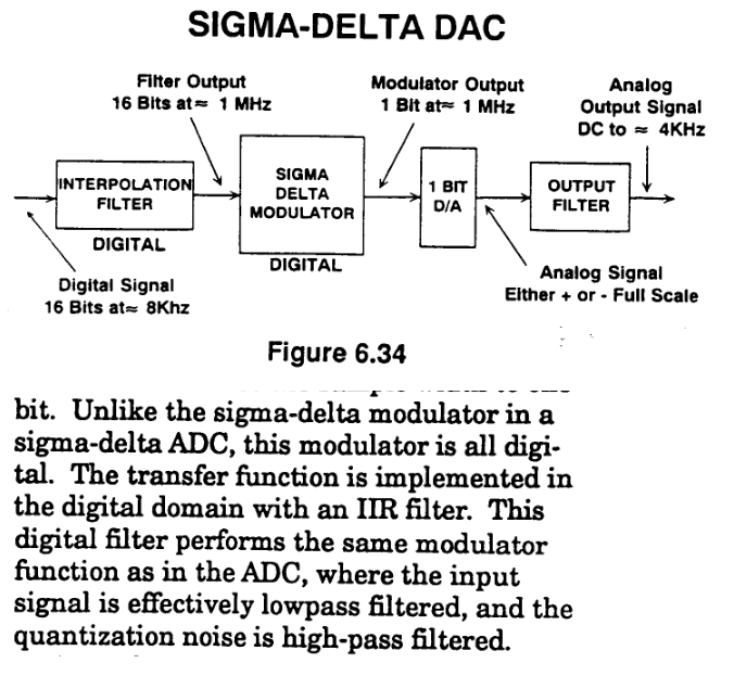

IMO you guys are talking about two different things a 1 bit SDM (or modulators in general are not purely digital systems, an FIR or IIR filter is.
The modulator front end is not a "digital concept". I took a lot of flak years ago (almost 30 by now) for daring to suggest a two chip converter with SOTA bi-polar integrators and comparators glued to CMOS logic. Talk about not politically correct.
Please correct me if I am wrong, but I am under the impression that the modulator is a completely digital / discrete time concept for a DAC, just not an ADC. The feedback is done before conversion and the output is just another bitstream.
For example:
http://acoustics.ippt.pan.pl/index.php/aa/article/viewFile/635/554
https://www.analog.com/media/en/tec...es/292524291525717245054923680458171AN283.pdf
http://www.ti.com/lit/an/slyt076/slyt076.pdf
