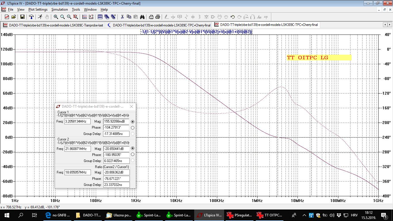

Yes, I know, but I didn't realized the benefit of the compensation scheme back then. That's why I asked the benefit of the complex compensation as I could do with one cap, -0dB up to 1kHz and the 20kH THD is even better. Now I realized that with using your compensation scheme I would have less compromises. I don't think this compensation has timing issues as it works on 'VHF' but I'm not decided yet whether it will present difficult load for the front end or not.

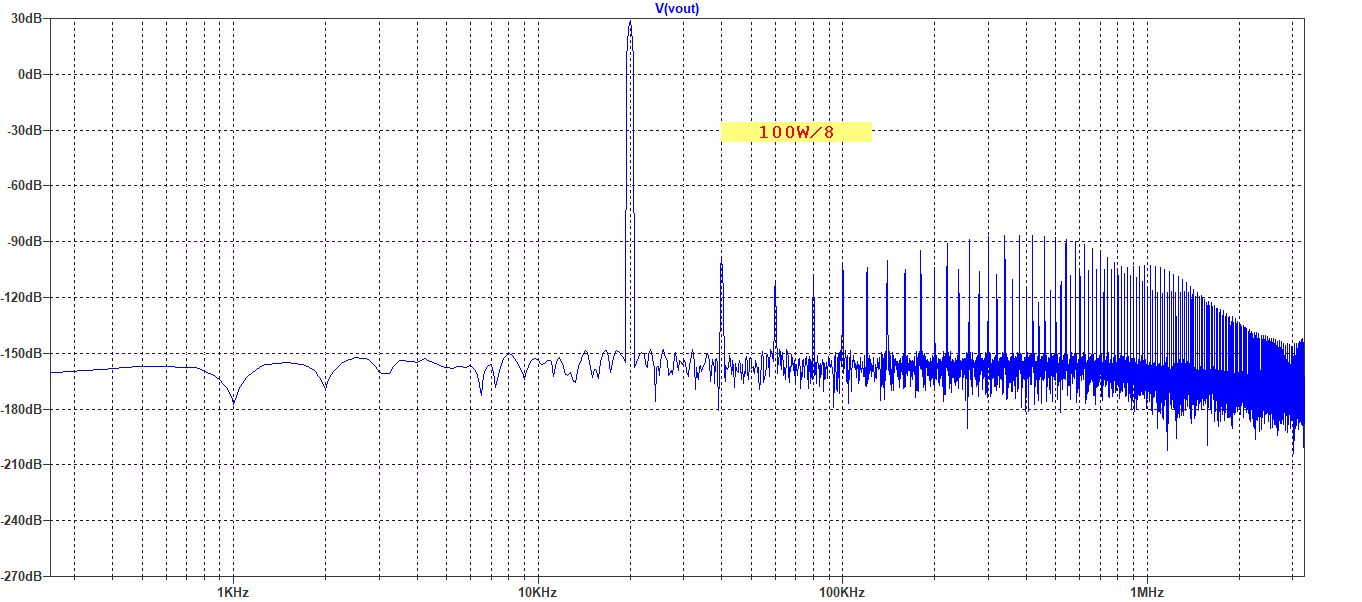

This is my ThermalTrak VFA Loop Gain with OITPC. Not flat up to 20kHz but has 80dB of feedback at 20kHz very low THD20k, and it's very stable, but I still prefer CFA. By the way TT amp with TMC has 60dB of feedback at 20kHz.
If a VFA can be designed to approach the technical 'quality' of CFA, why do you prefer CFA? Can you HEAR differences (or just because it is easier)? I remember about the VFA versus CFA debate. Imo, as long as one know how to design a VFA, there should be no difference between them. Unfortunately though, I haven't seen any single VFA that complies.
Current on demand, inherently symmetric circuit (simpler by this) and no bump at the output at switch on. As the feedback is low impedance it's less dependent on a stray inductance/capacitance.

No. VFA can have loop gain flat until 10kHz and higher. For example is amplifier that using OITPC compensation by Dadod.

Dadod said about CFA. But you said VFA can not have open loop gain flat until 10kHz, which is wrong. Loop gain = (open loop gain) - (close loop gain).

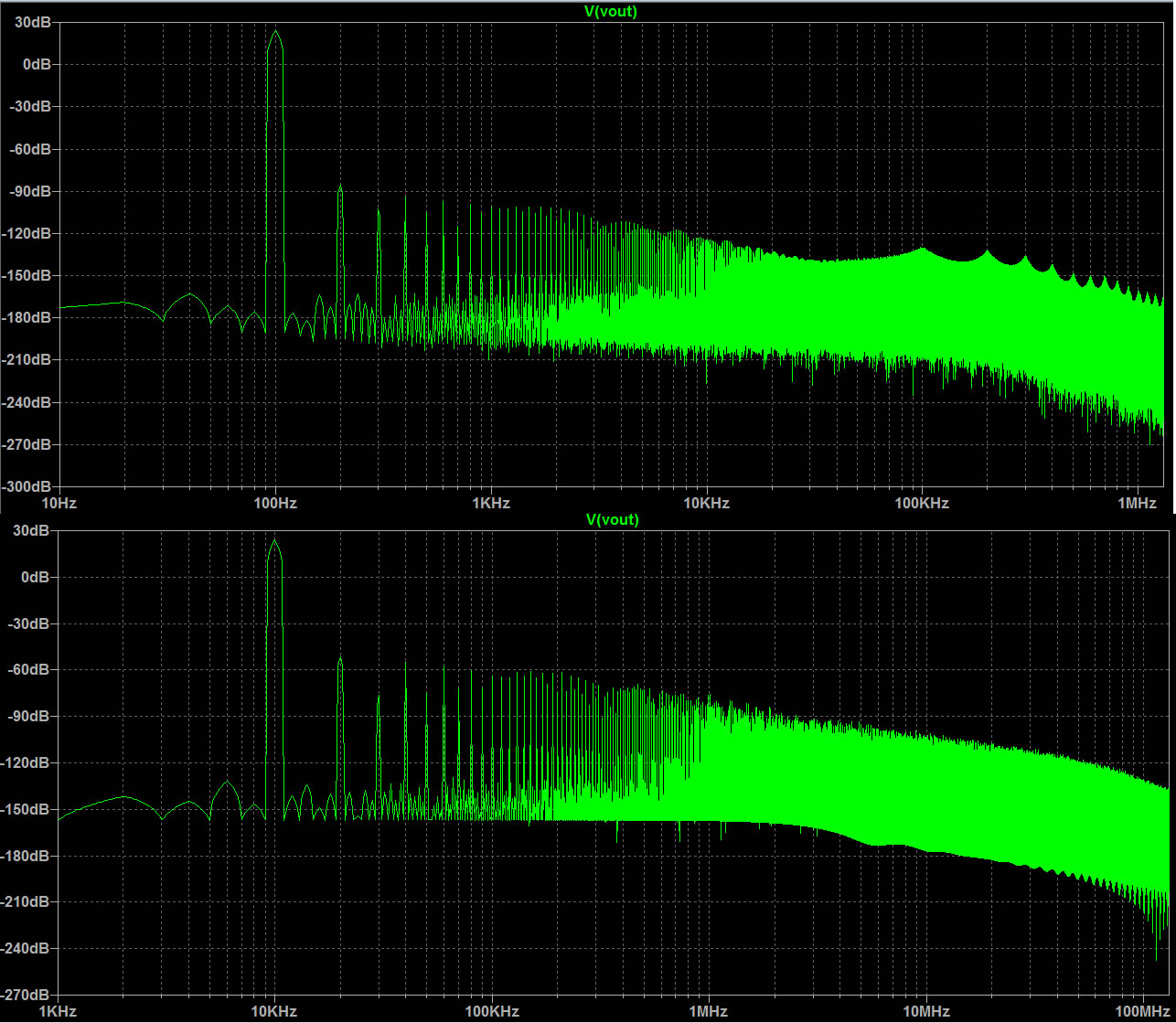

Bob Cordell picked that up in his book*. He convincingly showed that in a modern, reasonably linear amp to start with, feedback clearly reduced ALL harmonics, not creating new ones either.
I have posted the relevant graphs repeatedly at diyaudio. Unfortunately, those who's agenda is furthered by misleading the audience will not be interested at all in the real facts so they never get mentioned. And so the misconceptions are propagated.
The question seems very thorethical, on my point of view, as most (all ?) modern solid state power amps use GNFB.
More important for me is this question: are harmonic distortions components that are situated out of our audible range and out of the bandwidth a tweeter is able to reproduce (>20 000 Hz) audible ?
