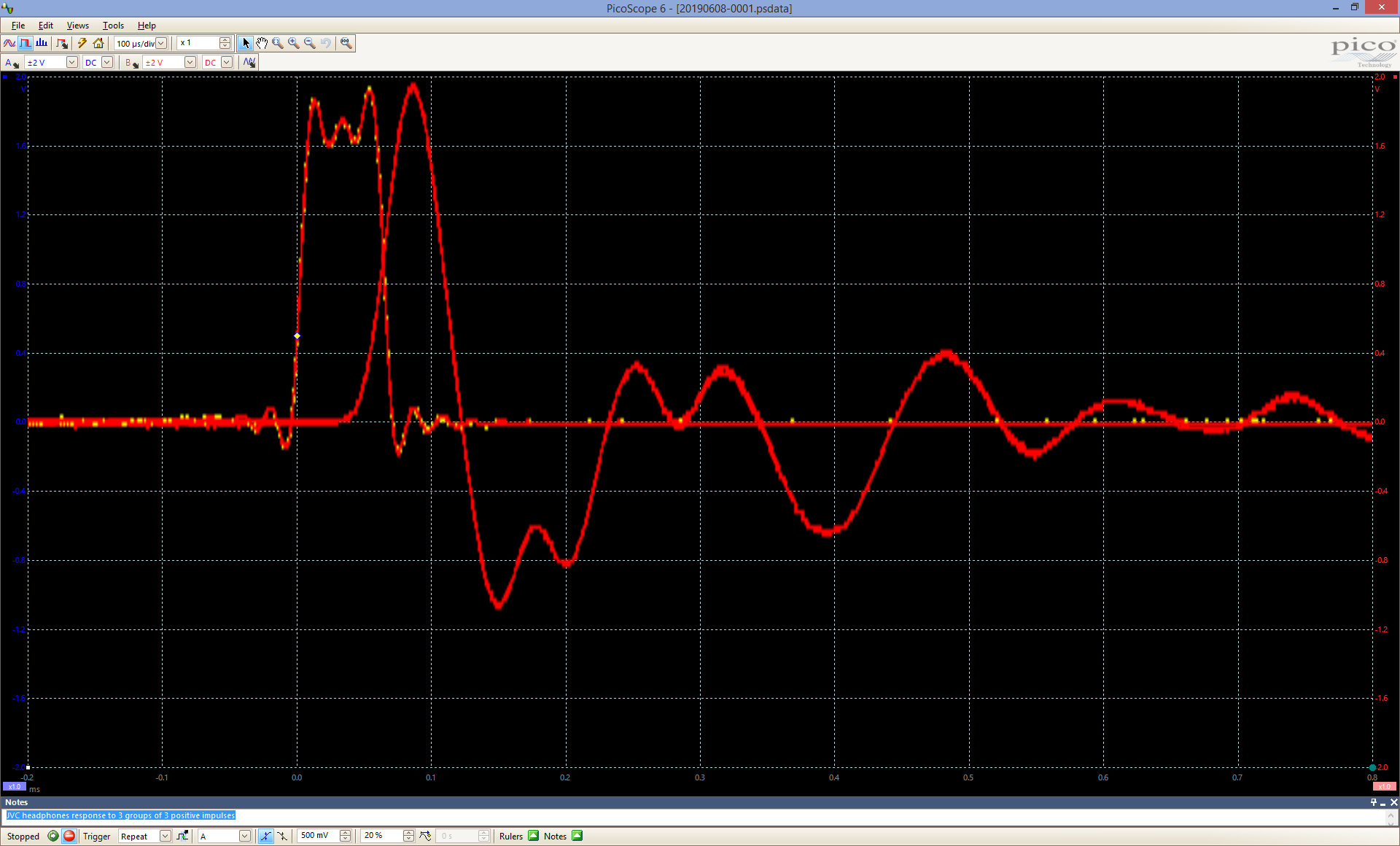

Dan, maybe the last remark to your question if the impulses in the groups were same. Attached is a record of all 3 groups of 3 impulses in persistence mode, that means all shown at the same screen. Both electrical impulses and JVC headphone responses. We can see that both input impulses overlap and responses overlap and there are no differences between the impulses. This shows that all the perceived audible "differences" are a result of brain evaluation of the ear signal. As we know, this evaluation is time dependent, so the impulses in the train of impulses are perceived differently, even if they are same. What we hear does not necessarily means that it exists, it exists in our mind only.
Hi Pavel.
I have revisited the test and discovered I had reset a SRC enable function in VLC Player so was running at 44k.
On second listen with dac definitely running at 96k and knowing what to listen for ..........I found several spots around the central listening spot and around the room where I had good central apparent sound source for the first triple and Left skewed and Right skewed pulses for the second and third sets respectively.
I also found spots where I had good central source and could not tell set 2 from set 3 and other spots where set 2 and set 3 apparent positions were reversed.
These results were at standing height or half standing, and when sitting with ears at tweeter height I found it harder to discern direction skew but sets 2 and 3 definitely sound longer and smeared compared to set 1 where the pulses sounded 'crisper' and 'shorter' in all listening positions.
These are all very fine differences and moving the head sub-mm is plenty enough to mask or reverse findings.
If the pulses were repeated with less delay and longer pulse sequence I think the direction discrimination would improve.
Conclusion, These short and intermittent (stacatto) pulses and only three repetition sets are not quite enough information for the brain to reliably filter ambient/room reverb sounds and then reliably discern fine source direction changes.
If you want to put more sequences up I can take another listen.
Dan.
Edit Re the 22k filtered file, I found the LPF filtered file sounded 'brighter' and 'wrong' in the manner that HC filters can cause a slight high mids lift before roll out (and rumble filters can cause a slight bump in mid bass).
