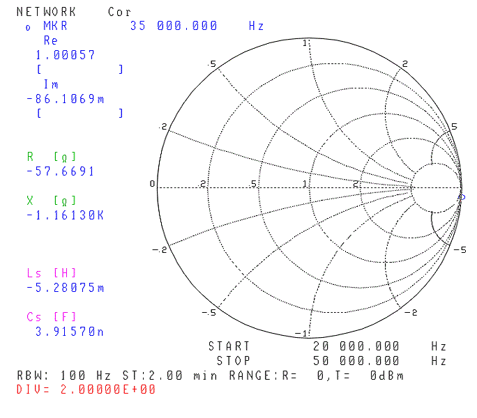

I actually remembered I built some time ago a half decent LF directional bridge (certainly better than the examples provided above, directivity was around 30dB), in the context I was looking to measure an output stage input impedance, up to the ULGF. So I dusted this bridge, got a roll of 50m of RG316 50 ohm cable and here are the results:

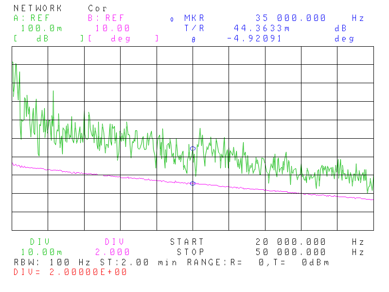

- Calibrated the directional bridge port using a 50ohm calibration kit. After calibration, the reflection magnitude and phase are illustrated in the first attachment. -65dB and phase all over the place are pretty good numbers, but this does not mean that the directional bridge can discriminate -60dB of reflections; the directivity still limits the measurements, the chart only shows that systematic errors are practically eliminated (or buried in the noise).

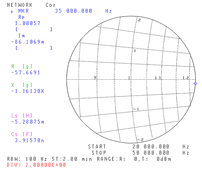

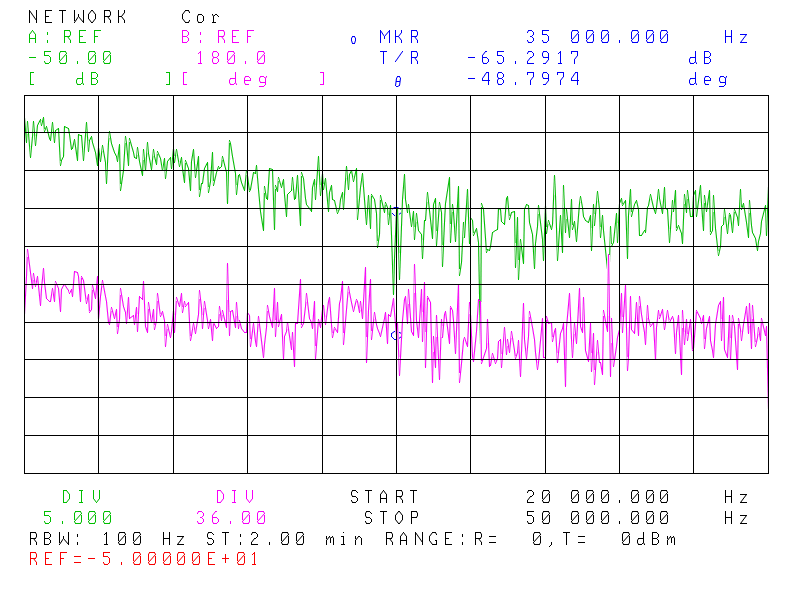

- Now measuring 50m of 50 ohm cable, open ended, between 20KHz and 50KHz. The result is shown in the other attachment, with the Smith chart full and magnified by 20dB.
For those less familiar with the Smith diagram, here's a few facts. The Smith chart is a convenient way to represent the complex plane. A open circuit is a dot on the right side of the of the horizontal diameter, while a short is a dot on the left side of the horizontal diameter. The frequency is the parameter of any curve on the Smith chart.
As the frequency varies, there is a trajectory on the Smith chart that shows the complex impedance; a frequency independent 50 ohm impedance will show as a dot right in the center of the Smith chart. The horizontal diameter corresponds to the real axis, these are pure resistive values, from zero (short, left) to infinity (open, right). Anything else has a real part and an imaginary part. The upper half of the Smith chart are containing the inductive impedances, the lower half the capacitive impedances. Very important observation: the Smith chart shows normalized impedances, to the characteristic impedance. So the results are independent on the magnitude an phase of the characteristic impedance. It would not make any difference if we would consider the characteristic impedance whatever impedance a speaker exposes at it's terminals, and the system could be calibrated to the characteristic impedance by connecting the speakers straight to the directional bridge. Nothing would change!
Circles with the center in the chart center are constant Gamma (the reflection coefficient) and the radius is exactly the Gamma value (the Smith chart is a unity radius circle). So a full circle would mean total reflections on the load (Gamma=1). That's what we are after, to see how much of a reflected we have. Recall that the standing wave ratio SWR is the ratio between the incident and reflected wave amplitude and SWR=(1-Gamma)/(1+Gamma) so a full circle in the Smith chart is also a constant SWR circle (once again, the frequency is the parameter).
So how do we interpret the measurements herein? Up to 50KHz, the 50m cable impedance terminated open is, and remains, an open. Even on the 20dB expanded chart diagram, it is still and open, for all practical purposes. Now, to get to a second order effects, the 50m cable is in fact capacitive; it has about 4nF of capacitance, which at 35KHz has an impedance of -1.6Kohm (compare to 50 ohm) and the real and imaginary parts of the impedance (normalized to 50ohm) are Re=1.00057 and Im=0.0861 These values are showing that at 35KHz the Smith plot is on the unity circle, with very little capacitive impedance to speak off. Being on the unity circle the end result is that Gamma=1 and SWR is virtually 0. For the hell of it, I calculated Gamma=0.997 and hence the SWR=0.004 or -47dB. This value is much lower than the estimated bridge directivity, so this value has actually no meaning/validity/interpretation, being just a number. But what this experiment shows is that 50m of 50ohm cable at 35KHz has a standing wave ratio SWR under any reasonable measurement capability. If some is able to find a LF directional bridge with a 60dB directivity, I am willing to redo these measurements. I'm not holding my breath, though.
These results are showing what is actually expected theoretically: any TL has reflections at any frequency. However, these reflections are almost impossible to measure at audio frequencies and can hence be safely ignored. Wait, do I hear Dan saying he can hear these?

P.P.S. Some may entertain the same data shown in a conventional magnitude + phase plot. I'm attaching this as well. Net result, 0.04dB losses on 50m and an almost linear phase shift drop due to the 4nF of the 50m open ended TL capacitance. Same ****, another view.
