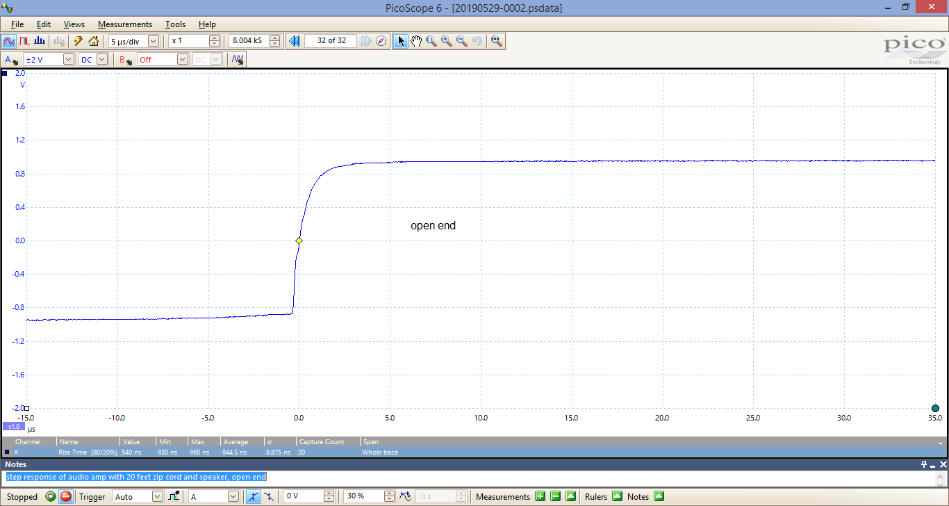

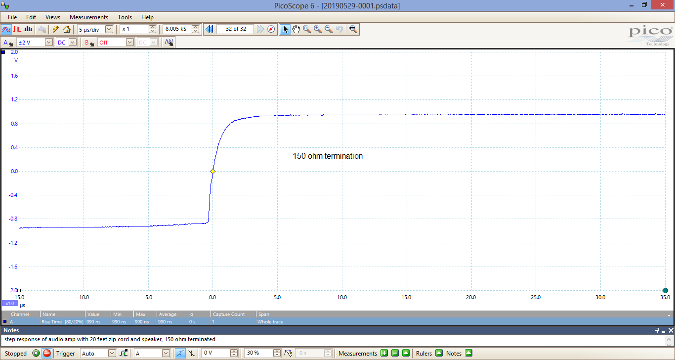

Just measured at speaker end behind 6m cable zip cord, speaker connected. Amplifier with Tr = 1us approx.
1) open end /speaker only/
2) 150 ohm termination added
There is almost no difference and also no cable reflections are seen in none of the measurements. Class A non global NFB amplifier. So, what is it really all about???

With the greatest respect JN, I stand by my earlier assertion. I might be more convinced if I could see the cable behavior separated from the speaker load characteristics to judge the relative effects of each.
