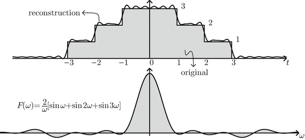

There are always reflections. Maybe think about it this way: suppose you have a 24-bit dac with no output filtering so that tiny steps are produced. Obviously, the steps can reflect from the other end of a cable since they have RF frequency components in the step edges. Even if the steps are so tiny in amplitude the are buried in noise, they are still there and can still reflect.
Completely irrelevant. Attached is the Fourier transform and the reconstruction of a staircase signal, grossly approximating a half sine.
Now imagine a 24bit staircase approximation of a sine and figure out what is the difference to an ideal delta function. The reflections may occur on components which are far away from the delta function, which are virtually zero, whatever scale you are looking at.
If you mean transmission of serial digital data over a cable, that's also irrelevant; some simple math will show immediately that since all pulses are suffering the same "reflections", the clock recovery will fix any timing errors. Pathological cases excluded, of course.
