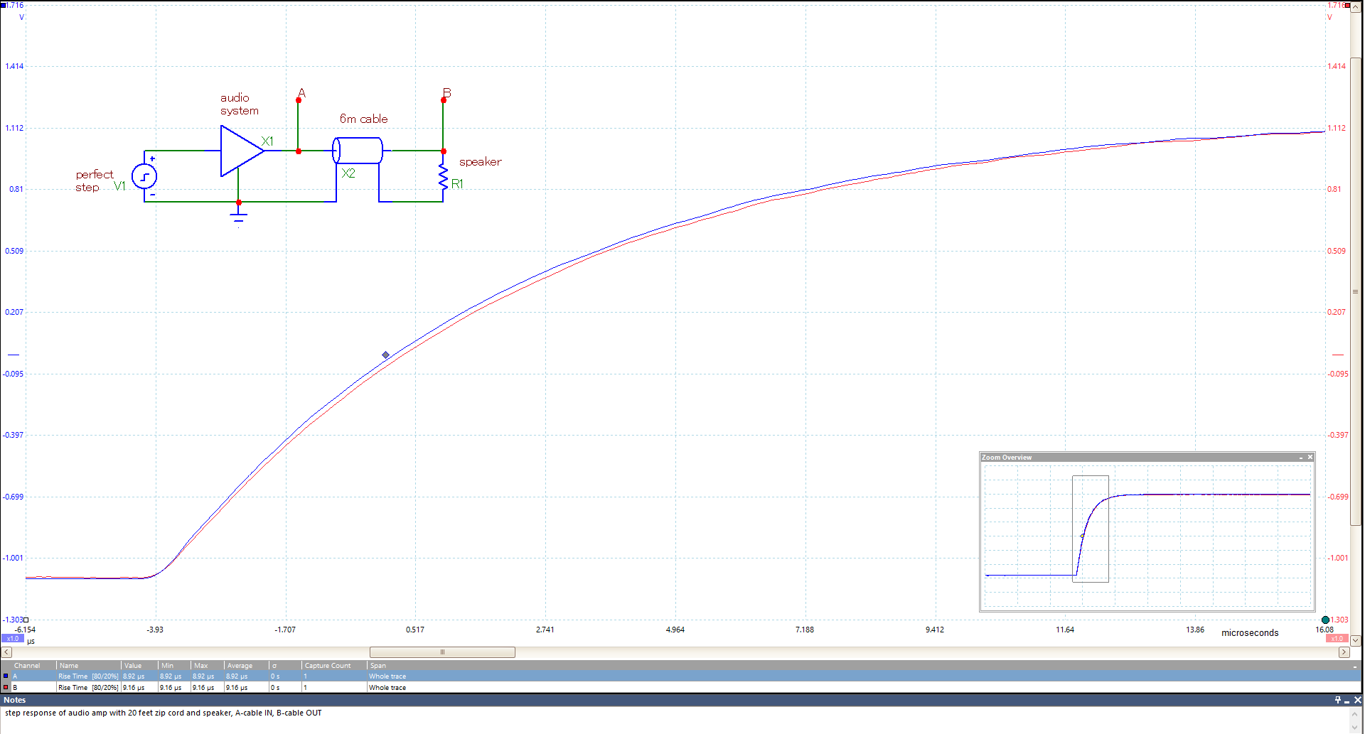

I do not think so. Will DC have any reflections? And please let's not speculate about DC turn-on, which may have infinite BW and infinitely short rising edge. I speak about BW limited system as audio is and I am saying there are no reflections if signal components at the cable input have all wavelengths in orders longer than is the cable length. That's why I am posting my experiment measurements, BW limited audio system is driven by a perfect step at amp input, but the cable only sees a BW limited step and no reflections are created. Different time delays between input and output cable signal do exist during the rising edge, but they are in tens of ns up to 100ns range, which is unimportant for the audio system, which will mask this effect.
Thank you very much for your comments and for creating the graphic. I think I understand your point better now. It raises another question: how sensitive is the audio system to pathological speaker cables? (A good friend has the MIT cables with the large, heavy, sealed lumps on both ends - mandatory for his Spectral amplifier - and they're maybe 4 meters).

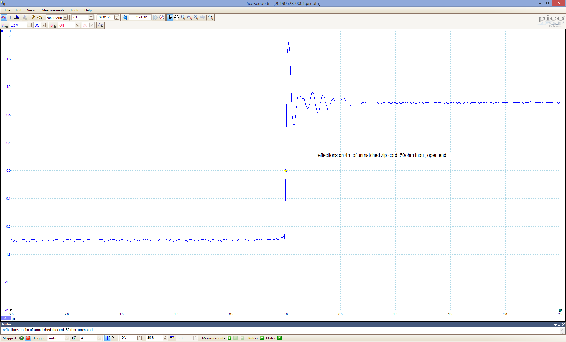

Reflections on an unmatched zip cord, 4m. Zgen = 50ohm, cable output open, measured at output. This is something that audio signal from an audio system will never create. But yes, as JN mentioned, settling time is in microseconds to damp the reflections.
Could-you make the same measurement, in a situation closer to the real one: across one of your amp (to get a real low source impedance and limited slew rate), and with, say, a 6 Ohm load ?
But, well, I do not want you to waste your time in useless measures of which we know the result: 0, nothing, nada.
Especially if we compare with the acoustic signal from a tweeter that would replace the load ;-)

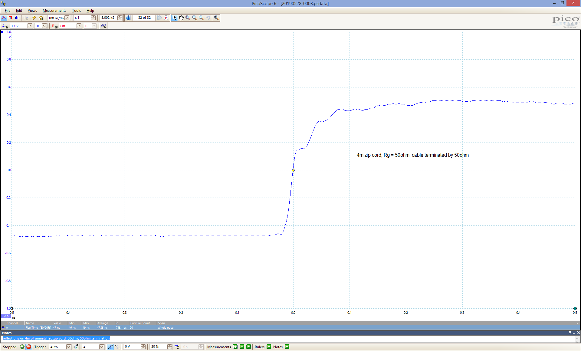

4m zip cord driven from Rg=50ohm and terminated with 50ohm. We can see much faster settling with no "ringing", still there is a reflection because terminating impedances are not match to cable Zw.
However, again, audio signal will never create this phenomenon.

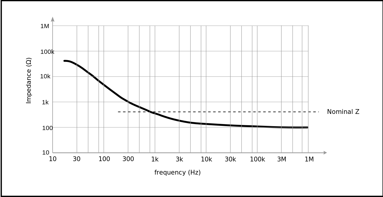

Nominal Impedance
Dan.
