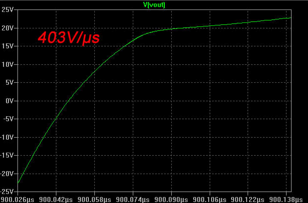

the "all transistors inside saturated" slew rate
I believe this is just an attempt to get rid, or, at least, reduce the effect of the input filter by overdriving-it.
What interest us is the slew rate of the part of an amp INSIDE the feedback loop. So, we have to remove the passive input filter before to measure the slew-rate of an amp. Saturating-it by a large signal input signal is a way to be sure that you will have the full level rising time at the output. The slope can be non linear. Reason why this 10-90% of the full excursion measurement standard ?
The good practice is to have a slew rate lot faster than any audio signal slope, and to ensure, with a low pass input filter, that no parasitic component can never reach this speed. I like to overkill this aspect. And current feedback topology as a way to achieve this.

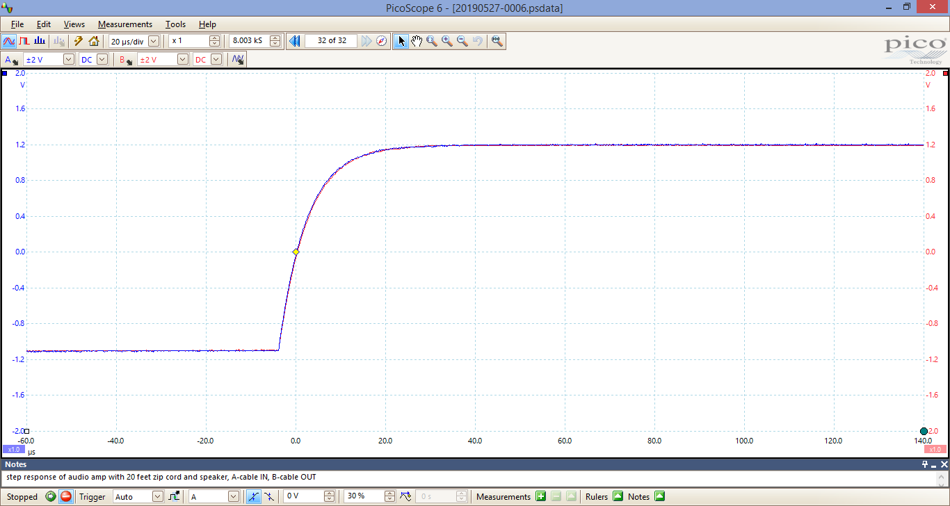

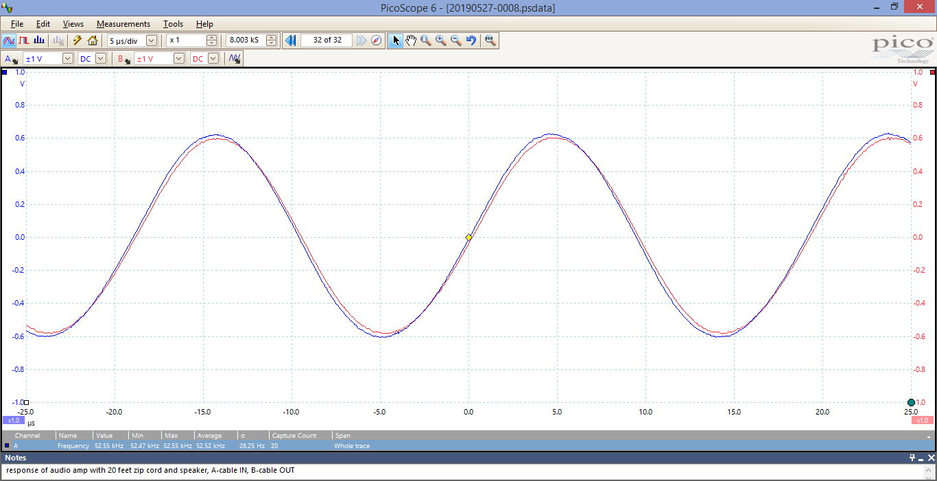

Last one on the cable "audible" ITD phase shifts. Now I have compared the input and output of the cable. The amp is driven by a very good step (about 5ns rise time), measurement is made simultaneously on amp speaker terminals and behind the 20 feet of speaker zip cord, loaded with my speaker box. Blue - cable input, red - cable output. Sorry, I do not believe in cable induced "phase shifts" being audible. The wave properties do not play any game in audio frequencies.

You know, we pitchfork wielding EEs call this (in those particular cases when it makes sense) “rise time”. And it’s not a constant, that’s why we use a particular way to define it (time from 10% to 90% of the rising signal amplitude).
“Slew rate” is reserved for something else which does not depend on the signal amplitude.
You give a perfectly valid definition. That said, an analog slew rate can be defined as the rate of change, as in volts per microsecond.
Many amps can reproduce a hf signal if it is small amplitude, but raise the amplitude and the amp will not follow well.
People often confuse slew rate with slew rate limit. Slew rate is a signal property, and it depends on amplitude. Slew rate limit is an amplifier property.

Below is a step response just now measured on an audio amplifier with 20 feet of zip cord speaker cable and loaded with a speaker. Measured at speaker. Where is the problem that you are describing?????
Look at your time base. Given that humans are sensitive to ITD at the 2 to 5 microsecond level, do you believe that your test setup is capable of resolving an impedance dependent settling time at the timeframe humans are capable of?
Try that using resistors from 2 to 2000 ohms. (I typically do the 2,5,10,20,50,100,200,500,1000,2000 thing as it graphs well on log "paper")you might want to go finer resistor resolution around the cable RF z.
What you will see is that the voltage at the load will rise the fastest at cable z, probably 120 to 150 ohms unless it's landscaping zip with really thick insulation.
If you plot time to say 80% vs load r, you will find a cusp at cable z.
If you then bracket that graph using the high and low impedance of your typical speaker (just in the audible frequency range of course) you will see the span of delay that zip cord will cause on that speaker.
If the span is below 1 microsecond, it is inaudible. If it is over 2 microseconds, audibility cannot be discounted.
If you parallel 4 zips, each with slightly different twists, the repeat all, you will find that the resultant delay span is heavily reduced. I estimate a 25 to 30 ohm cable is optimal, and keeps capacitance low enough to keep even fast amps happy.
