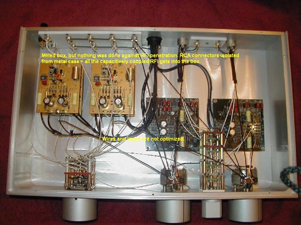

Robert, here is an inside picture of a CTC Blowtorch with a Vendetta phono stage added.
The white wires are the silver ones, for sure, and they are NOT coaxial, just single hookup wire. Most of what you asked is on the circuit boards, that are thick copper traces with a clear advanced solder mask. Everything electronic is pretty well contained on the individual circuit boards, including power supply buffers and servos.
