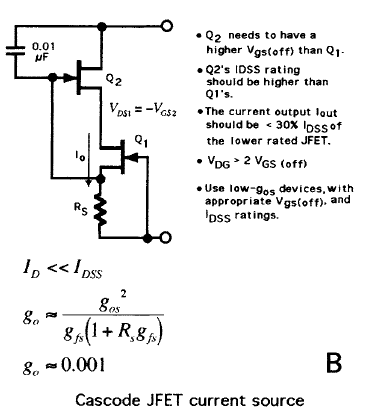

OK, so how about this. My concern as an average DIYer is a good Vref solution. We are considering so far the following:
1. the Norton zener, i.e. an appropriate jfet in series with an R||C filter. Please note that a resistor in parallel with a capacitor DOES act as a band filter IF it is being fed (in series) with a current source. That's the job of the jfet. The CCS can be improved by two cascoded jfets, but they have to be chosen appropriately (see figure). I already posted a few pages ago a list of jfets which are recommended in that book for this purpose.
Advantages: flexibility in Vref value. With suitable C across R, low noise (how low to be established). Cheap.
Disadvantages: to be determined.
2. lm329 or equivalent low noise voltage reference.
Advantages: low noise, less affected by temperature variations, specifically created for this purpose.
Disadvantages: large variation in noise specs (John pointed this out), but noise can be reduced with an RC filter.
3. LEDs in series, possibly with a capacitor across them. Clearly some LEDs have less self noise than others. Issues that are not IMHO well addressed: unless one can measure it, how can one choose from the multitude of LEDs? How effective in reducing noise is the capacitor across them.
4. Zener reference, possibly with RC or C filter.
IMHO it would be best if we could characterize more completely these four solutions in terms of what they offer and what they lack, instead of claiming one is best. If the solutions are well defined then everyone can choose what is "best" for them individually.
Please correct any issue I might have gotten wrong here. Comments are welcome.

If temperature stability is required. All that has to be added is a series resistor between the gate and source of the jfet, of the proper value to give about .75-.8V Vgs. This will give 0 tempco. The Id will change from Idss, droppng from 8ma to 4 ma for example with a suitable J203 jfet.
Reference to this is pp.103-104 Toshiba 'Small Signal Transistor' manual 1992

Better VDS stability comes with lower values of drain current compared to IDSS. The tempco may not be such a difficult thing to deal with, and possibly may even be compensated for in some way.
Right now, I'm pouring over the "Low Power Discretes Data Book", by Siliconix, 1989. Any other information source would be appreciated. I have read over Walt Jung's "Sources 101" a couple times already.

Glancing over the Toshiba notes again, I found a serious oversight that I made. You have to subtract .7-.8V from the Vgs (off) and use that voltage to bias the device This makes it MORE difficult to calculate. I will have to work on it, but it may be difficult to do with just any jfet, and get something useful. For example, a 2SK170 can never be TC zero, because its pinch off voltage is too low. Interesting problem.
Therefore for Zero TC, stick with a Zener equivalent reference. Everybody else, it doesn't matter that much, anyway.
