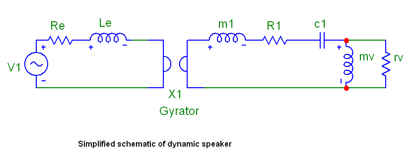

This is done by the impedance of the speaker.
This impedance is composed out of the voice coil DCR, ....
Further the impedance of the speaker contains an inductive component....
In another twist, as the magnetic force is not constant for a given excursion of the driver and the Back EMF of the driver ....
So to me, knowing how a speaker actually works ...
Thorsten, your view of speaker impedance is oversimplified.

Joachim, that's correct, some of the elements of the schematics I posted are non-linear. Anyway, the speaker impedance may not be simplified to voice coil resistance, voice coil inductance and some mysterious "back EMF". This "back EMF" is just mechanical impedance and radiation impedance recalculated to electrical side of speaker schematics.
Pavel,
I merely presented three major points. You should not conclude that they represent all or even most of what I know or that I intend for them to represent a comprehensive picture. That would require several volumes without the references section and I have no time or will to write them.
The simplified model of a speaker you posted however is grossly oversimplified to reductio ad absurdum level and hence useless as it excludes all non-linearities...
