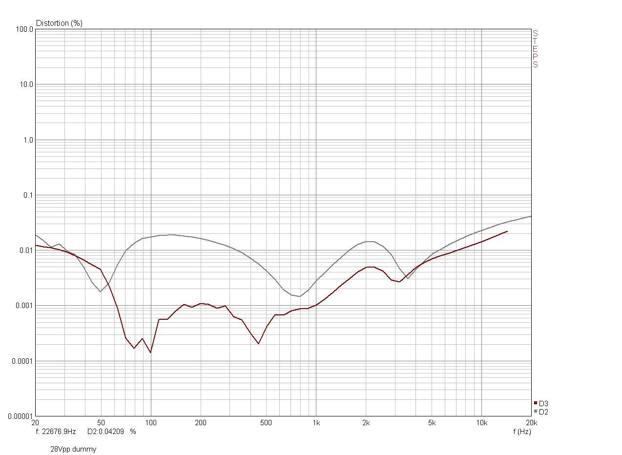

Yes, dummy loads may be much more revealing.

Not sure what you mean. There was no sarcasm intended. Everything I said was intended to be positive and constructive. Are you referring to my use of the term "benign resistive loads?" Everybody agrees that they are relatively benign loads for amplifiers, including John.
I agree that it is a good idea to test amplifiers on real loads, but what is the point in frequency response curve of an amplifier loaded on some complex load? What would you get loading any "standard" signal generator on such a load? How useful will be the curve? And, finally, what is "Standard speaker"? Which one? Even if you limit choice of speakers by a single dynamic full-range cone speaker, which one is "standard"? 😉
