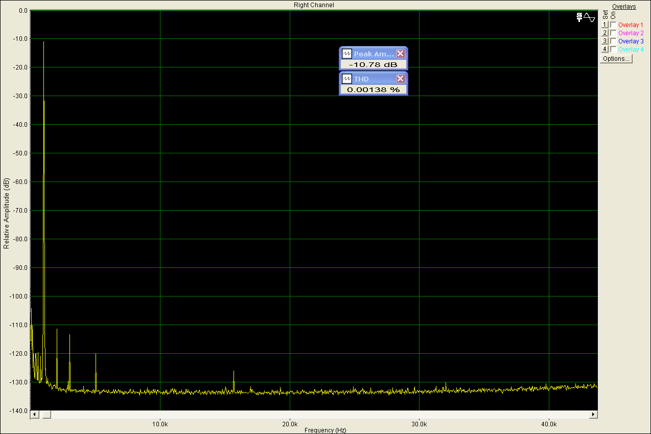

I would like to return to the JC 3, as it seems to be a SOTA opamp phono preamplifier.
I am curious about the design of the output stage, as it seems to lose linearity into 600 ohm load
Parasound Halo JC 3 phono preamplifier Measurements | Stereophile.com
I do not get this worsening even into 50 ohm load with my preamp output stage, that's the reason why I am asking.
The attached plot is into 32 ohms.
Pavel, just a side question if you don't mind. I see missing H5 & H7. I've seen that in other circuits, too, but don't know why. As low as they are in your example I can't think you'd ever hear them, but just out of technical curiosity, is this a pattern that has a known cause? It's not the first time I've seen it is why I ask.
Thanks for your question. Frankly speaking, I am not so sure about special importance of the 7th and 9th, if they are somewhere at -130dB and less.
The absence of 5th and 7th in my plot most probably results from
1) inherent linearity of the output stage (diamond buffer with idle current at 40mA)
2) overall excellent linearity achieved also with a help of global feedback.
Usually the 5th is still visible in the output stage. It does not necessarily indicate cross-over distortion. The cross-over distortion is indicated by almost constant level of high order harmonics up to very very high orders. The 5th and 7th is definitely present in my design, but it may lie below measurement noise floor or even preamplifier noise floor.

Since when is 10 volts into 600 ohms relevant to a phono stage? Headphone amp? Sure. Phono stage?
Are you driving that 32 ohms with 10 volts? If so, you're talking about 3 watts. Are we talking phono stages or headphone amps?

Well, not in the plot shown. Anyway, the load is 32 ohm - about 20 times lower impedance than 600 ohm.
Are we speaking phono stages or headphone amps - in my designs almost no difference. I can drive 32 ohm with my line stages, and also the phono stage has the capability to drive loads like 100 ohm.
I can make a measurement of the phono stage at 10V/600 ohm, in case you are interested in it.

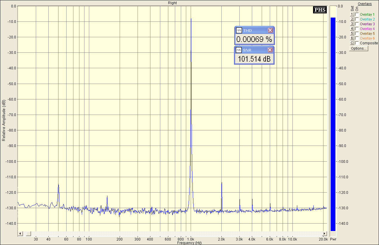

Okay, by the time I have measured my phono at 10Vp/600 ohm. Any comments, Steve?
What's my point? My point is that the distortion into 600 ohms indicates to 'something'.
"Something" perhaps. But not "something" relevant that I can see.
