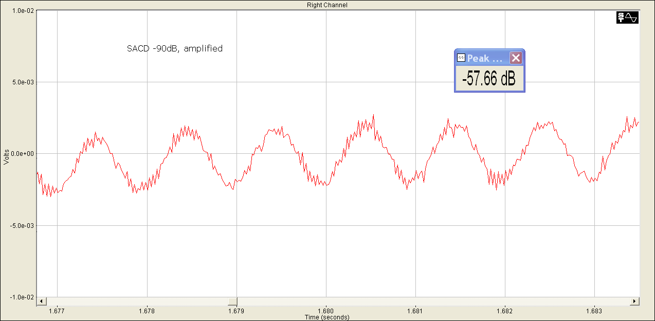

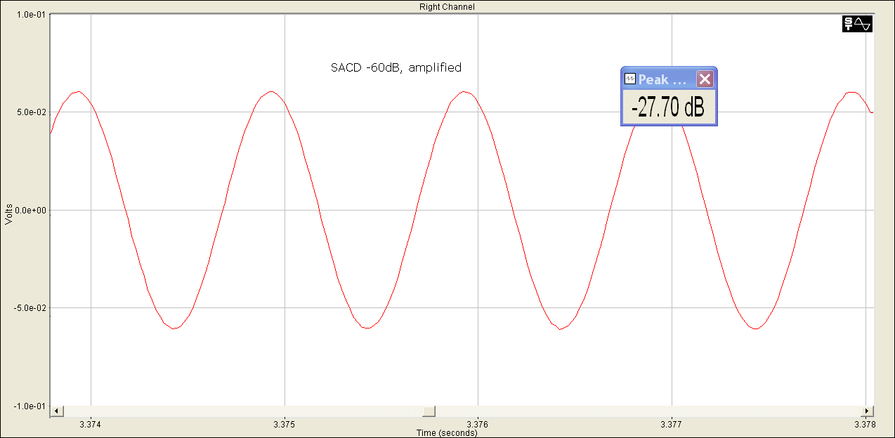

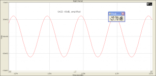

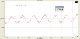

I like to be clear and bring results.
Just now I have prepared 2 measurements. SACD output at -60dB and -90dB. Amplified by my line preamp + power amplifer and measured at power amplifier output terminals. The result is attached. I encourage anyone who speaks about low levels from tape or vinyl to show the same, especially -90dB would be of my great interest. The results I am showing are 24bit/48kHz digitized and the smaller signal reflects A/D imperfections.
The AD is likely also Delta Sigma. What would you expect to see from this?

Thorsten, the A/D is of no importance now. Even with non-ideal A/D we can see that SACD has no problem with -60dB (even spectrum is clean, no harmonic frequencies) and still has enough resolution at -90dB. The vinyl and tape will have NOTHING at -90dB (except for noise and hum) and something very poor at -60dB. The low level is no answer to me. In fact, both vinyl and tape are unable to reach SACD resolution. In case you listen to good recordings of orchestral classical music, you MUST be aware of this fact.
I have attached the non-averaged non-FFT signals, and non-filtered samples, for the reason I know you do not like averaging 🙂

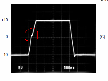

I could share the following practical observation, a different one. I have an analog kind signal generator, which gives a bit non-perfect square-wave test signal (there is a small and very short time overshoot (spike) at the front edge of the signal). Although a periodic signal, but some use can be extracted.
Usually stable and fast amps ignore this spike, they react by forming sharp front edge that smoothly approach the upper steady-state level.
My last power amp with jFET output stage, the best sounding one, shows at the output square wave some single small overshoot bump, a bit wider than the original spike, without any ringing after on, but the amp does not ignor this spike, it is able to react on it, in spite that it is close to a "mad" situation caused to amp by the sharp front edge.
This is not -60dB situation, but such specific features of an amp depend on many things, not reflected in simulations, including internal EMI and real properties of NFB.
I interpret this as a characterisation of fuzzy distortions of an amp. If the small extra bump is not shown by the amp, hence some signal information, in the "digital" sence (yes bump - no bump) has been lost. Further, I suppose that in a complex musical signal we can also find cases when low-level bumps are lost at the output. And this is sensible to human's hearing.

do you speak about step spike like this? How "long" is it?
I speak about small spike on the top left corner of square wave, like an overshoot of signal generator schematics, it is hardly visible at scope's screen vertical spike (just as a short piece of vertical line), the remaining square wave is perfect. One usually does not notice such spikes without enough attention to it.
If to speak about 20kHz square wave, the spike duration (settling time of the generator) is very short, since it looks just a piece of line.
I presume that it is a good (of course a bit exaggerated and too tuff) test situation for dynamic properties of an amp, in order to judge, does it become "insane" during fast transients and is it able to react on small signals within settling period.
I understand, maybe if you changed time base settings to a faster one, you could read the length of the "corner" overshoot. Based on the fact it is a 20kHz square, you are probably at 5us/div time base setting. The overshoot may be as short as 100ns or less, and many audio gear would not transfer it. The question is if it might be audible, I really do not think so, as it would reflect at MHz's in frequency domain.
