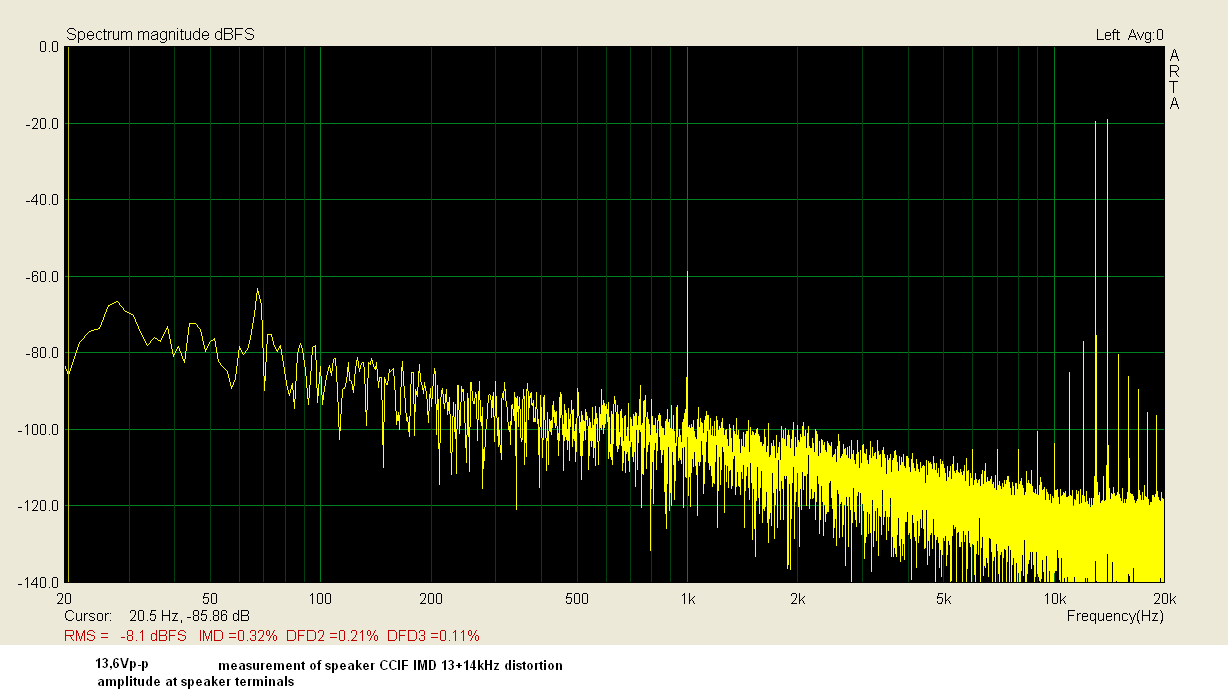

How can an amplifier that measures like this Boulder 2050 monoblock amplifier Measurements | Stereophile.com
sound awful?

Depends on your expectations. If you prefer an amp which has audible coloration, one whose output is a replica of the input will not be satisfying. Likewise, if you want tubes and an amp has transistors, its technical capabilities will be secondary.
PMA's comment is irrelevant- the measurements provided go well beyond a single-number THD/IM measurement and quite nicely show the capabilities of this amp.

Can you actually tell me which of these measurements is the one that shows that the Amplifier will sound good? Because this is what potential customers want to know.
To be honest, looking at the residue for the THD test is interesting, listening to it could be quite useful... What I see there does not necessarily please me, to be honest.
