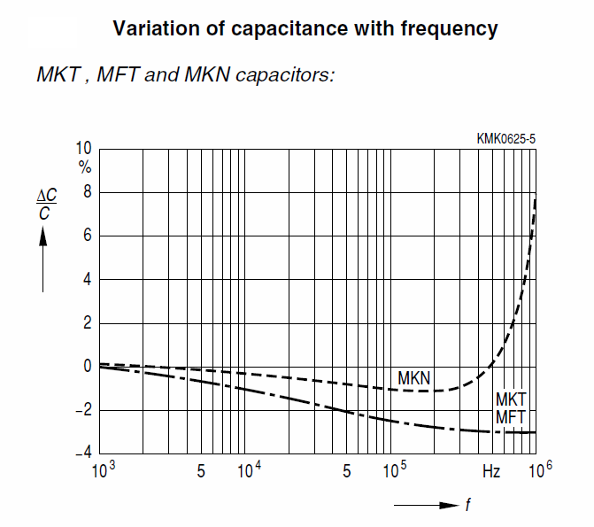

The problem we had with the polyester cap was similar (shape) to the attached simulation, but settling time was longer, in us. The 'overcompensation' or 'undercompensation" was not the case, it was impossible to tune it by R,C values (R//C-R//C) divider. It was fixed with polypropylene caps.

Probably yes, as the issue we had was more related to frequency dependence of capacitance of the polyester capacitor. For the R//C-R//C voltage divider the DA is not that much an issue (parallel resistor). But is a GREAT issue in the (R-C)-(R-C) divider (series damped capacitive divider). I was building these dividers for HV impulse voltage measurement, and I have been aware of the DA problem since the beginning of the 80-ties.
You are wrong. MKN is polyethylene naphthalate. MKT is polyethylene terephtalate = polyester. I have already told you that you know almost everything, but just almost.
Polymers I know reasonably well. Polyethylene terephthalate (PET) is a polyester. Polyethylene naphthalate (PEN) is a polyester as well. There are lots of polyesters- anything with a structure of -R1-CO-O-R2- is a polyester. PEN and PET have different Rs, but the same polyester structure.
Polyethylene is a polyolefin, a completely different polymer family. No carbonyls, no oxygens, no aryls, just (CH2)x.
