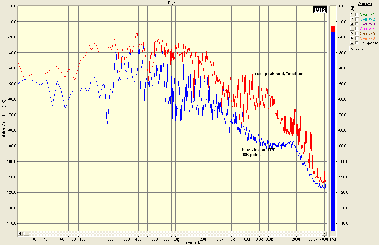

Modern recordings can be technically brilliant - but most are rather sterile.
Hereby the link to live recording of Louis in Prague, 1965. The file size is 95MB, just one song in 24/96.
Free File Hosting, Online Storage & File Upload with FileServe
