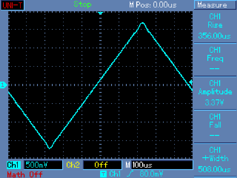

PMA can you give me the 'recording level' of the triangle wave that you recently showed?
Sorry if I should have missed something.

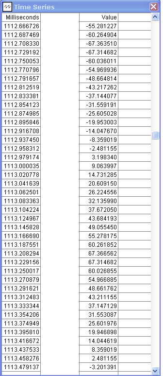

I showed 3 triangle waves, so I will try not to confuse the issue. In the D/A - A/D linearity test, the full scale of the A/D converter was +100%/-100% and triangle wave was +67%/-67%. The investigated portion (linearity measurement) took +15%/-15%.
The triangle that I have shown later was the D/A output captured by scope. You can read the Vp-p from the image, I am posting it again.
So the triangle wave you just posted is at 15% of full output, sort of 'operating level, or OVu on an analog recorder? Sorry, my scopes don't do 'tricks' so I have problems with interpretation, sometimes.

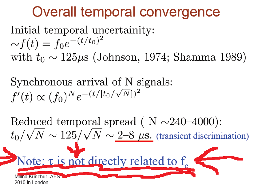

biological variations don't necessarily (or even often) result in smooth, symmetric, "infinite tail" distributions
assuming Gaussian distribution may be the "default" for some "canned" statistics packages but that doesn't make it predictive of real world data distributions
My objection is the that some want to "assume their conclusions" as a method of argument, "proof"
to me the data in peer reviewed papers is not yet conclusive, 44.1 kHz is not "obviously" inadequate for Music reproduction
many accepted measurements, detailed models for human auditory perception, even typical recording, playback equipement limits make it plausible that content above 20 kHz isn't of 1st order importance
small "time difference" resolution numbers, IATD, keep getting misinterpreted as implying channel bandwidth of ~ 1/dt - this has been pointed out as logically wrong many times now
see Kunchur's slide: (my Paint underlines, arrows)
