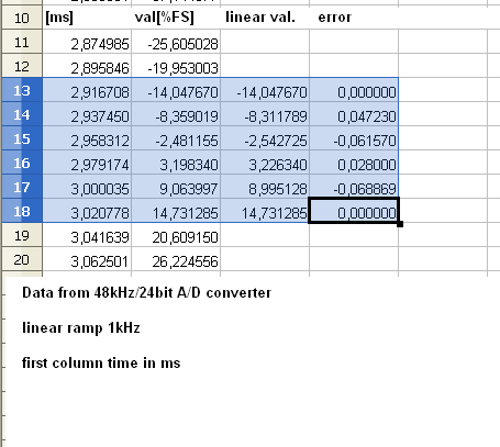

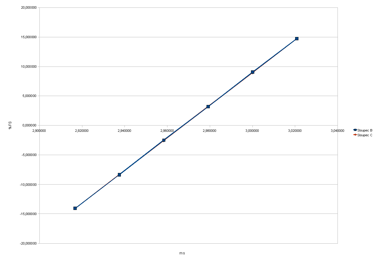

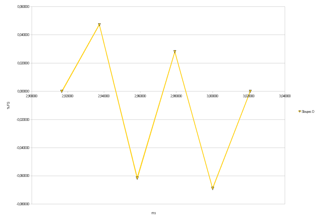

S-D A/D conversion
Okay, I tried something myself.
48kHz/24bit A/D converter is excitated by linear ramp (1kHz triangle), created by 24bit D/A converter. A/D samples are stored in memory (no averaging, one-shot measurement) and shown in the table 'graf0'. Linear and settled portion of the triangle is shown. Then we can see amplitude values after A/D, expressed in %FS. The 3rd plot is the error of captured data vs. linear approximation - from endpoints of the plot.
P.S. Amplitude of the 1kHz triangle is from -67%FS to +67%FS. The portion in plots is from -14%FS to +15%FS.
Scott Wurcer wrote "Of course with a 24 bit audio converter you are not going to resolve 24 bit LSB steps nor are you going to see 10 bits of noise."
Of course-Agree 100%. I was using PMA' picture illustrative purposes.
