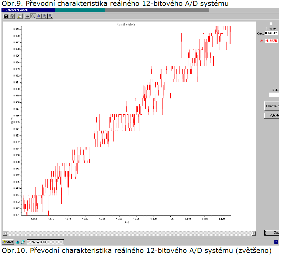

But it is dither and by use of a process that is a Genuine Miracle (TM) it makes this 12 Bit Device behave like it was a 32 Bit one. 🙄 Well, I guess enough faith can make even a 12 Bit (actually even a 1 Bit) DAC into a 24 Bit one...
Ciao T
Definitely, the best reasoning would be the captured transient, rather than walking and laughing. Everyone is able to walk and laugh 😉
Or just let's show something like this:

Now what is all this "fuzz" we are seeing? 🙄
I know what the defenders of the orthodox faith will say, it is NOT Fuzzy Distortion (as such does not exist).
Looks to me like the absence of an anti-imaging filter, but PMA didn't really provide any information on what he was measuring and how he was doing so, so it didn't invite much comment.

Those guys don't have anything near a 24bit converter - they claim 124dB in 25.6kHz bandwidth. They get better only by going to a narrower bandwidth, looking like they use synchronous averaging. Been there, done that, back in the 1980s. 😀
It may well be that a multibit converter does not show this type of behaviour in its tranfer function . . . but for a bitstream converter you have to include the filter to get the final result. This is like trying to compare two amplifers -with one of them missing the output stage.
