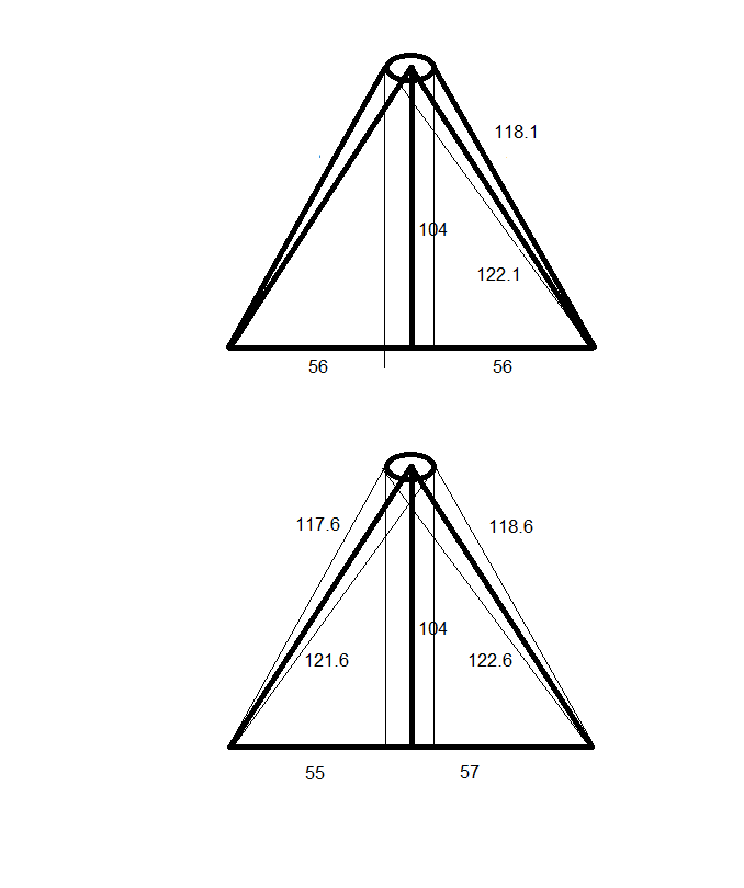

Somehow we ain't talkin! When you slide your head one inch to the left, both ears move. If the delay time from the left speaker is 10.00 ms to the left ear and the signal from the right speaker is also 10.00 ms, when you move a bit that may change to L 999 and R 1001 but at the same time the right ear goes from L 10.00 R 10.00 to L 9.9901 to R 10.0099 or some such. It is the differential we are considering.
OK, let's do the numbers. Assume inter-ear distance is 8". Distance from R speaker to R ear is about 118.1". Ditto L speaker to L ear. Move the head an inch. Now the distance from R speaker to R ear is 118.6", L speaker to L ear is 117.6".
How about the cross terms? Centered, the L speaker to R ear is 122.1", as is R speaker to L ear. Move that inch, and L speaker to R ear is 121.6", R speaker to L ear is 122.6".
Rather than worry about head movement, concentrate on what the shift of the image means in terms of IID and ITD.

I did. You can derive that from the numbers I gave. You can even consider pan-potting and the effects of the head shift on where the image will be perceived, just as you can with the simple time delay in one channel (that doesn't actually happen in any but the cheapest and oldest DACs). In fact, since the intensity shifts here are negligible, the small head shift reduces to the simple time delay.
Centered left ear to left speaker 118.118" to right speaker 121.115"
Centered right ear to left speaker 121.115" to right speaker 118.118"
Agreed.
Offset 1" Now left ear to left speaker 117.648 to right speaker 122.642
Offset 1" Now right ear to left speaker is 122.642 to right speaker 117.648
Agreed
Now what does each ear perceive? Obviously it hears the combination of sound in terms of time, amplitude and frequency. As is often modeled we are concerned with the lower frequencies as there is ample evidence that at higher frequencies other localization factors come into play.
So centered both ears are averaged at 119.617" of time delay. Offset one inch moves the average to 120.145" But here is the kicker, the ears are not comparing that movement, because they one isn't hearing the first number and the other the second. They are both still hearing the same combined number. So they don't detect the change.
So how far do they have to move so that one ear gets a .1356" difference in the path length average from the two loudspeakers?

I thought the question is why don't things sound different when you move your head fractions of an inch. Which was logical based on the 10 us perception claim.
My point was that Pythagoras guy answered the question even before Curl was born.
I understand that sometimes what is clear to me is not being communicated by me to others clearly.
Now if you want to know what happens when two sound sources have a 10 us shift between them, you start getting a notch at some above band frequency so that probably is not a good test as there are valid arguments as to what is the upper limit of hearing or is it detecting phase shifts?
