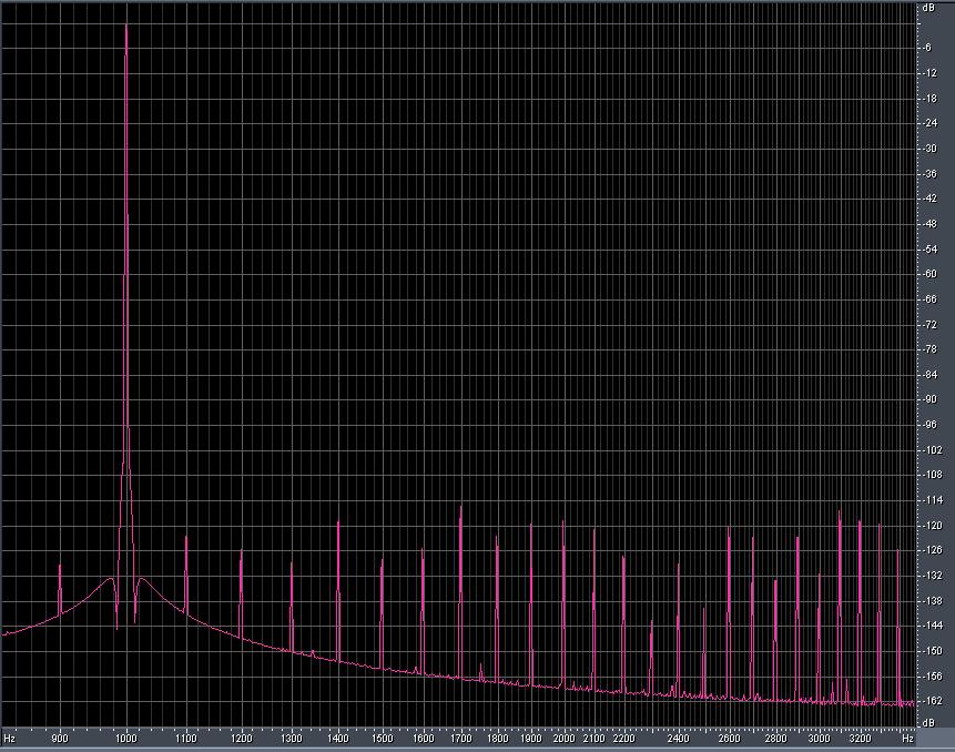

This is a very commonly stated fallacy. Properly dithered digital conversions do not have any "discrete levels". None. Nada. Zip.
The mathematical (and practical!) result of the properly dithered A/D/A conversion of a bandlimited signal is the original signal, plus a small noise (the dither) plus a delay. The resultant signal includes *all* of the original signal, including components smaller than the dither. All the way down to the weeds.

The dither math I've looked at shows that you also have to account for the sampling bandwidth. So at upper midrange frequencies (where the ear is most sensitive) a perfect dither will only allow the equivalent of 19.5 bits of resolution.
If you have a different math treatment I'd be interested.
You've illustrated by earlier point perfectly. As long as we consider signal-to-noise, noise floor, and resolution as being the same thing, we can make all sorts of incorrect conclusions.
You've illustrated my earlier point perfectly. As long as we consider signal-to-noise, noise floor, and resolution as being the same thing, we can make all sorts of incorrect conclusions.
How do you distinguish between ultimate S/N (dynamic range) and number of bits for a given bandwidth?
You used the term "resolution," then used an equation for dynamic range. You'll have to define "ultimate S/N" to get a sensible answer, and it is not the same as "dynamic range." "Number of bits for a given bandwidth" is another fuzzy term. I don't mean to be pedantic, but if you're going to be quantitative, you have to be clearer about what you're calculating.

I use 20 log (2exp (#bits)) to give a digital equivalent to the Ultimate S/N ratio of an analog system. Ultimate S/N is from the noise floor at 15.9k bandwidth to clipping. Clipping is when the peak output voltage of the DUT is reached and is roughly equal to 5% distortion of a sine wave. This is pretty much the way the engineers I work with measure things.
What seems to be missing is an understanding of monoticity. An "X" bit linear D/A will have the most significant bit and all lesser bits accurate to the least significant bit. But the least significant bit will not be any better. So on an 8 bit D/A you will have 256 levels but if it is putting out 2.55 volts full scale the step size could be .01 volts but when the LSB is toggled it is more likely the change is .049 or .0149 volts. That is why dither does allow more information to pass but at a rising rate of distortion.
Resolution of an "X" bit D/A is as used by my cronies is 1/(2 exp "X").
S/N is the ratio from a standard operating point for Analog this is defined as 0 db(x?) and that is often based on the voltage equal to 1mw into 600 ohms, but not always. The peak operating level is then specified with a given distortion. As the limit is clipping the difference between .1%, .3%, 1% and the traditional 5% is very small, but different folks use different spec.s (.1% to 5% often has a difference of .4 db!)
S/N for a digital system has become from 1/2exp(Bits) to Full scale.
Ultimate S/N as mentioned is from the wide band noise floor (15.9K) to clipping. I use 5% when I make a measurement. To me this is the same as dynamic range.
