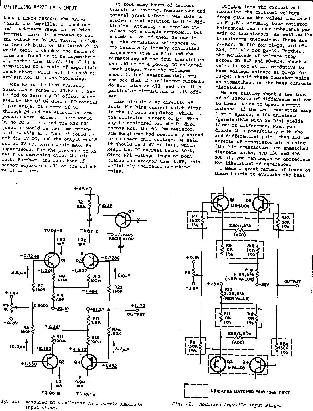

Jan, the potential for 'balance' with the Ampzilla should have been easy. However, IF you do NOT match the input part pairs, then you can have trouble. In fact, I suspect that real problems occured, if the emitter degeneration resistors were not added. That is the ONLY reason that I can see that they were added in the first place. Jim B is a good designer, but he does NOT throw money at his parts, and he would use less, if possible. More free lunches, you see. '-)
I was using the complementary differential input stage since 1968, BUT I used factory matched pairs of bipolar transistors, so I did NOT need emitter degeneration, AND I paid the price with a lower slew rate than possible. It was typical of amp design at the time. Check it out. Look at Marantz, etc.
Not my point. JB added the 'balancing emitter degenerations resistors' but it was still unbalanced. Why? He didn't consider the DC current going into the next stage from one side of the diff pair. That current was a significant fraction of half the tail current, so this unbalanced the input pair big time. Of course, diligent matching of input devices doesn't help you diddly here either.
So, clearly, the advise to add degeneration resistors to balance the stage is not wrong but it is only one part of the story, and even supposedly seasoned designers like JB can goof there.
jan
I don't see this as a problem, Jan. I have made worse, and it worked out. The complementary parts tend to push pull each other, for one thing. The differential is secondary. Also, the darlington buffer has maybe 5uA drive needed? Perhaps you can show me where I went wrong.
I didn't say you went wrong, why do you say that?
It should be clear from my post that I didn't imply something like a 5uA drive, when I said 'a significant fraction of half the tail current'. I don't remember the exact numbers, and honestly I have no intention to get up and spend another half hour to look for it, but if you have a half tail current of 1mA and your next stage takes 350uA clearly, that is a design oversight. I agreed with Walt at the time and still do. I would expect that you would also wholeheartedly agree with that. It makes the cry for matching input devices ridiculous, of course.

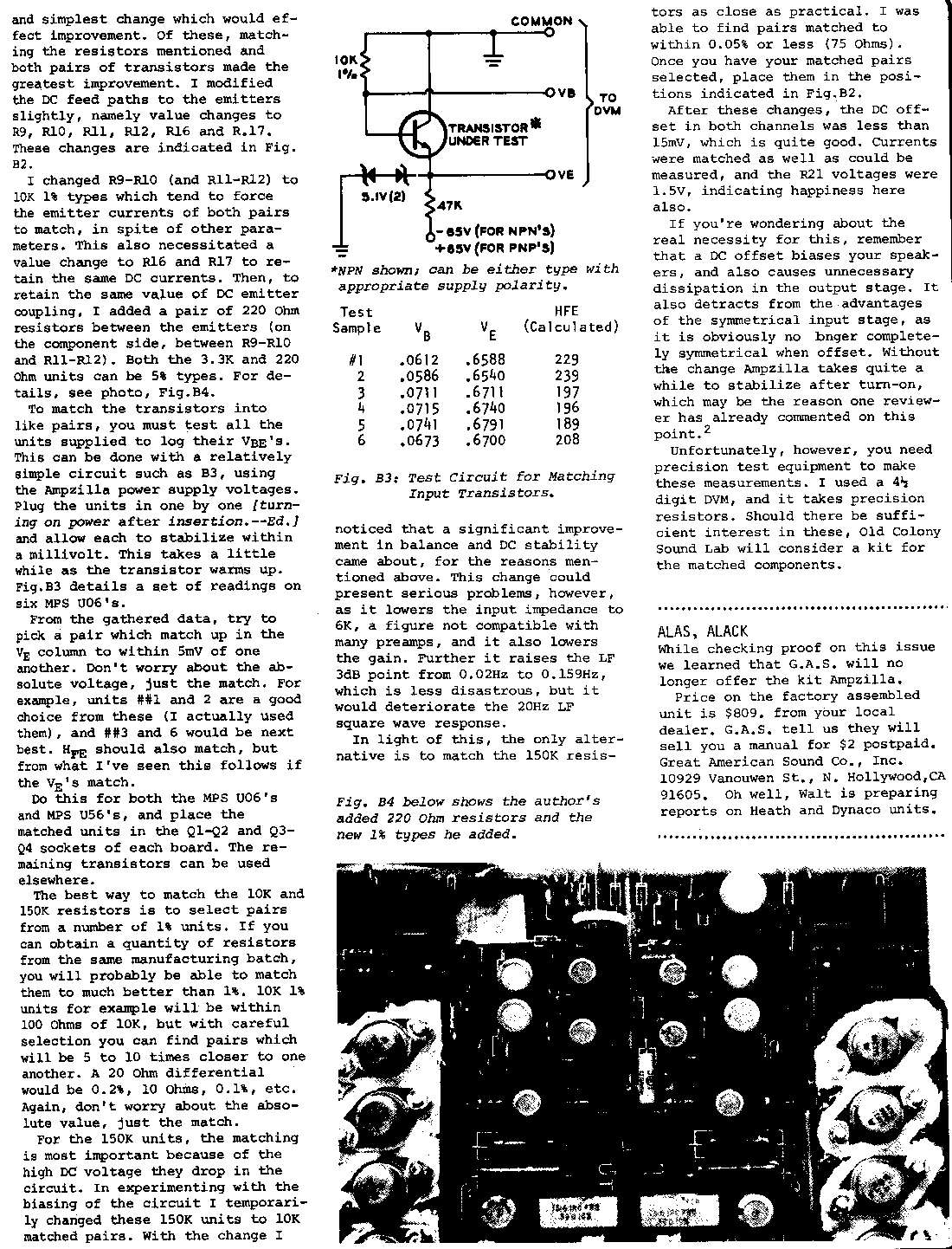

Jan, the issue that you mentioned is: TAA 2/1975 'Kit Report A Construction Report the Taming of Ampzilla'. On p. 16 Walt insists that matching the input devices is really, really important. He even thinks that an serious resistor modification might do the job, if you could not match the parts. Little else seems necessary, except that JB insisted that he later MATCHED the input devices. And so it goes! '-)
I called Walt Jung to get this initial info on the Ampzilla, today. You might follow up with him, as I did.
I guess what JB may have done is simply selected a collector load resistor on the basis of his desired LTP gain (i.e. 0.5*re*Rl for a non degenerated pair) and then tapped off to the beta enhanced VAs stage. The loop gain would be high . . . but the LTP balance very suboptimal. With non-miror loaded LTP's, you need to tweak the LTP load resistor to ensure the currents are balanced. As you say Jan, selecting the LTP transistors would do nothing here to resolve the situation.
Yes that's it, thanks for the heads-up. It seems my memory wasn't that correct; I just read the sidebar 'Optimizing Ampzilla's input' on page 16 in that issue. The unbalance apparently was the result, not as I thought from asymetrical laoding, but of rather loose accuracy of the involved resistors (5%) and 4 unmatched input stage transistors. Walt spend several hours to evolve a solution that worked, and it is instructive to read that part; he was already smart at that time 😉 .
Maybe I should put it on my website if Walt agrees, as a kind of 'case study'.
