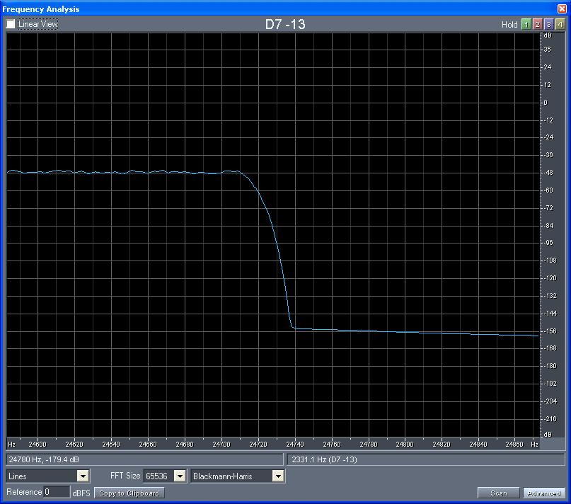

Again I don't care about the phase, you keep assuming I'm not familiar with the theory. Overlapped FFT filtering is well known and can be shown to be exactly eqivalent to circular convolution. I don't want a "discontinuity", I want the smallest sharpest transition within my numerical resolution. BTW there is no "energy" between the bins. The FFT and the time domain data contain exactly the same information. There is no energy in zeroed bins (some extremely small numerical noise maybe). You need to review windowing if you think FFT's only work on music perfectly if the tones are exact bins.
I don't have time to get Matlab up and demonstrate, but I remembered that Audition has a 24,000 point FFT filter. At 96k you can get a 30Hz transition at -108dB. This is only single precision float at 24000 point. I'm sure at 2^24 point double precision it will be <1Hz and approach 24bit noise.

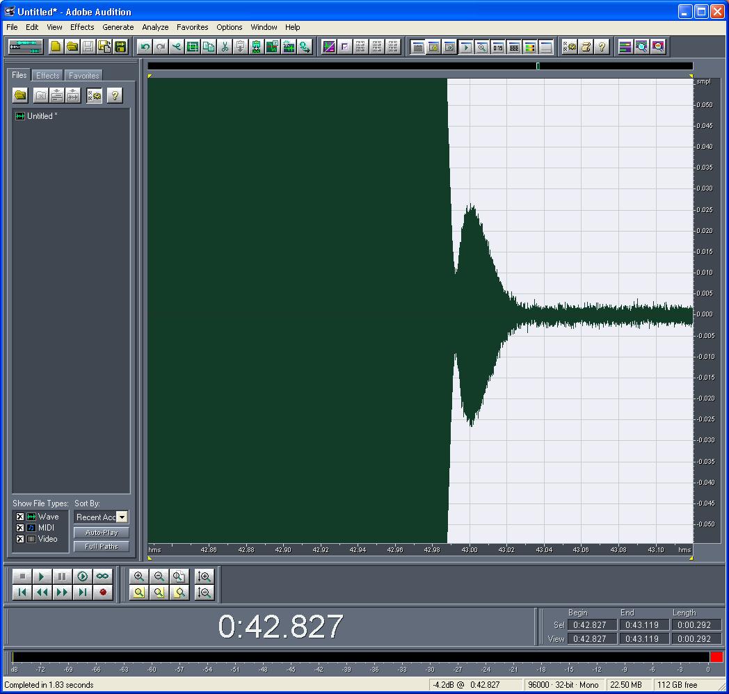

As for time smear in this meager example I did the very non-physical sudden zeroing of the time domain waveform. After about 120ms there is only the numerical noise. This is full scale noise over the entire 48kHz BW music has very little energy beyond 20KHz in any real world example.

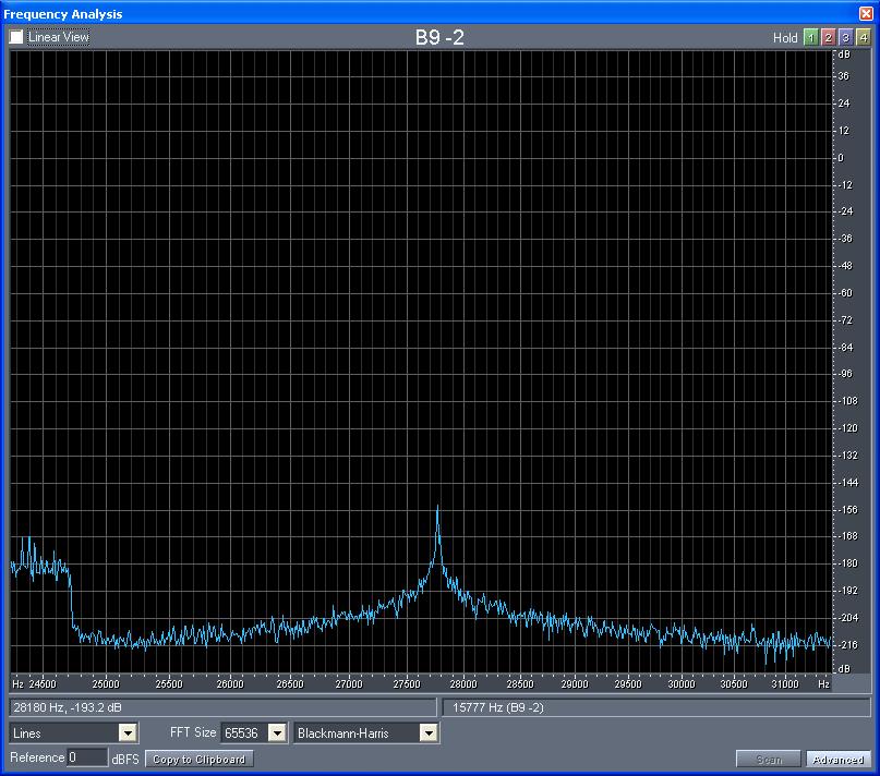

No, again the sidelobes are a mathematical artifact they do not exist. Here I took a 27,777kHz sine wave at full scale 0dB. The same FFT filter, -156dB attenuation and notice the side lobes remain symetrical and the ones that intruded on the passband are gone. Trust me they were well above the -180db noise from the creation of the sine wave (single precision). I was surprised that the process actually removed some of the noise above transition.
In fact I might add that no amount of filtering can work on the sidelobes, they are truely an artifact. I'm sure at least one of the programs on that site uses FFT based techniques. If you removed the restriction of real time processing I'm sure you could get one to do 192 to 44.1 with all noise and artifacts at the 24bit level.
Well, many people care about phase, including me. I really only objected to your claim that down-sampling can be 'perfect' ... if you relax the requirements, that hardly counts.Again I don't care about the phase, you keep assuming I'm not familiar with the theory.
I didn't say there was energy "between" the bins. I'm fully aware of the tradeoffs of windowing and how it works - I merely stated that windowing will not allow a discontinuity in the frequency domain.BTW there is no "energy" between the bins. The FFT and the time domain data contain exactly the same information. There is no energy in zeroed bins (some extremely small numerical noise maybe). You need to review windowing if you think FFT's only work on music perfectly if the tones are exact bins.
You attached a graph that shows pass band frequencies as high as 24.74 kHz... are you sampling at 50 kHz? You'll have aliasing with the low pass response in your graph if you're downsampling to 48 kHz, and certainly to 44.1 kHz.

Your attached graph makes no sense. I don't see that anything is 'gone' in that graph. Again, the pass band is too high for 48 kHz sampling, so I really don't see what you're trying to say here.Here I took a 27,777kHz sine wave at full scale 0dB. The same FFT filter, -156dB attenuation and notice the side lobes remain symetrical and the ones that intruded on the passband are gone. Trust me they were well above the -180db noise from the creation of the sine wave (single precision). I was surprised that the process actually removed some of the noise above transition.
