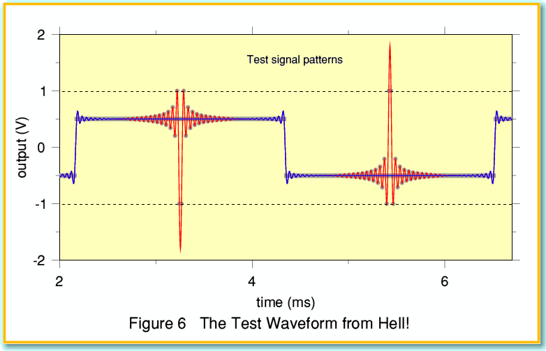

I believe it is a red herring - "pure math" results do not have to reflect real world hardware, signal limits - no digital music recording will come close to the conditions, and you may note his formulation doesn't include amplitude limitation of the sum of infinite arbitrary bandwidth limited sines
a known issue that can produce "higher than expected" peaks in a amplitude, bandwidth limited digital waveform is illustrated by the "over 0 dB fs problem"
illustration from: Over The Top?
shows what you can get by deliberate construction, applying the realistic limit that real DAC hardware will amplitude limit so the "run up" to the "over" has to be both amplitude and bandwidth limited
by "eyeball" that isn't an "infinite" slew rate - 2x maybe?
I believe I heard Bob Stuart claim better oversampling audio DACs do use saturation arithmetic in the digital filters and include 3 dB over range for the more common hard clipping of simpler music signals
and some DAW sw is "aware" of the problem and provide tools to view reconstructed signal to avoid the problem in the mastering

As statisticly improbable as it is a +crest factor event followed by a -one would be the maximum sample to sample delta one could observe.
