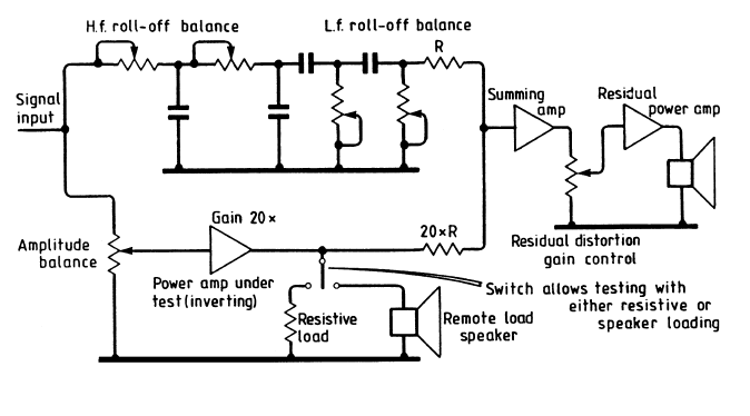

Try to think about real time difference input/output, this can catch all "deformation" of signal. No difference in signal (90-100dB under useful signal)= no audible differencies. So simple to understand. This is real situation, I tried many times.
You did try, but what exactly? Do you know, what differences between input and output signals are most important, what should we look via a microscope, and what can be looked at from 10m distance, what kind of input signal should be used?
Just these questions are the subject of many thousands of post. Saying that every distortion must be nulled, this fits a level of a beginner, who did not play with high level systems and designs.

I tried something like this.. It can catch all diferencies. You can use all signals, even music. Try to think about it.
Yes I know that schematic, from the WW article where you cut if from. Peter Walker I think.
IIRC it didn't really get any better than 60dB nulling or so. The problem is the phase shift between input and output that varies with frequency and may even vary dynamically unless you have a really good amplifier.

Where you see active components? The only is tested amplifier.Amps behind summing point (conection R, 20R) only amplify residual errors to audible levels for analyseYour measurement setup active components has its own intrinsic transient-kind distortions, that are much higher than the effects we are trying to catch.
You are really lost, You believe , you can hear in loud sound artefacts 100dB below this sound??And posted test is exclusively hearing related, no measurement instruments.I am lost completely from many of engineers arguments, like someboby does not distinguish -60dB, or -100dB. Everything depends on the system, including cabling, power etc. System is a measurement instrument in such a test, and who bothers to specify this instrument, in the hearing-related metrics?
2 jan
I get more than 90dB supresion in 20Hz-20kHz range.
Two good quality op amps could also be used here instead to give the inverting and summing functions. You could also then easily test for residual on the opamps ('test the tester'). Would be interesting to then feed the residual into a sound card.
