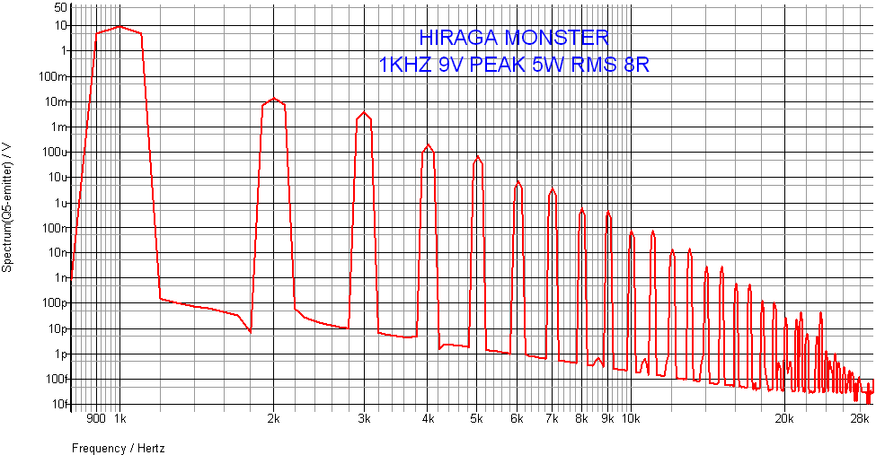

the Hiraga 20 watt class A amp was complimentary push-pull, which means it was likely odd-order dominant.
It was P-P complimentary, so it might have been odd dominate, but I doubt it. Mr. Hiraga was rather picky about the harmonic structure of distortion in his amps, so I can't imagine this would be too dominate in any harmonic or order.
I did not have the means to measure that at the time, and never saw it published. (Just square waves and such).
There is a model of it in the latest version of Microcap (V10) if anyone cares to run a simulation.
ComplEmentary....😉
Indeed, this amp has relatively high THD ratio by today s standards,
but the distribution is not odd dominant , at least according to Hiraga
as well as to the simulators.
