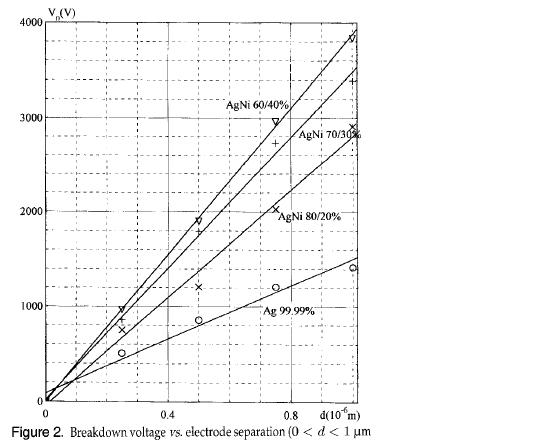

The issue is not "Does electricity flow through conductive metals", but "Is there a minimum voltage required to start the flow in connectors or other mechanical contacts?"
So the difference is now, "Is contamination always present?"
Is contamination always present in any practical audio interconnects, switches, or other contacts?
No relationship between the two.

I don't understand how the plot you post shows no relationship. This is a plot of electrodes placed distance d apart with an air dialectric? Looks like the Ni makes a difference in the breakdown voltage.
I'm sure I'm missing something here and haven't followed this switch contact discussion that closely, but maybe you could fill me in?

At 1000nm the breakdown is still >200V so I don't see any argument for non-conductive contamination separating a contact so it has a < 1mV barrier. Metal touching metal just conducts. I know the technical references are dense but the jist of the MEMS contact resistance calculation was to figure out the density and size of the actual metal touching metal regions and using standard electron conduction theory to compute it. The gaps and insulating contamination just don't conduct at all. My take on the absense of "micro-diodes" is that if copper oxide is the contaminant the surrounding conducting regions still have virtually no drop so there is no voltage to support rectification.

Scott, if I understand what you're saying, the issue is that the surface contamination is not homogeneous. There is a roughness on a microscopic scale as well. Where metal pokes past or is not covered by contamination and can touch the other contact, there is no real resistance. Where the contamination insulates, there's far less (or far far less) conductivity. The ratio of these two areas determines how much the contact fouls the sound (in the form of excess noise, sometimes correlated with the music), modulated by vibration, creep, and other mechanical forces.
There is no metal-thing-metal heterojunction with a 1nV (or whatever) deadband, especially in common metals used for electrical contacts.
Is this a correct summation?
If so, the answer is still the same- clean and tighten contacts periodically and try to minimize them.
Thank you for the explanation on the graph Scott.

I think metal slammed together in a vice conducts well.
Well the world won't end we still disagree. I don't see the point you are trying to make with that graph. If you go by that then my dirty contact shouldn't conduct until I reach a few hundred volts.
We could discuss two dimensional vs three dimensional pre-arc conditions but that isn't really what I think the issue is.
