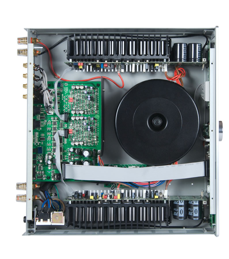

No. I mean wood bricks between 2 instruments. Once I had a customer who complained for slight hum in speakers. The reason was large power transformer's magnetic field that induced hum voltage in the preamp circuits. The whole issue was solved by putting preamplifier 10cm above power amplifier, rather than directly on its top. Just a place for a couple of nice wood bricks 😉
In this case it was not the wood that was relevant , but the distance created. The trafo should of been shielded , an obvious oversight.
In many so called "pro" amps , just a bare trafo. In the new Krells (below) , parasound , even my mid-fi Nikko - a steel circular "vessel" for the toriod.
