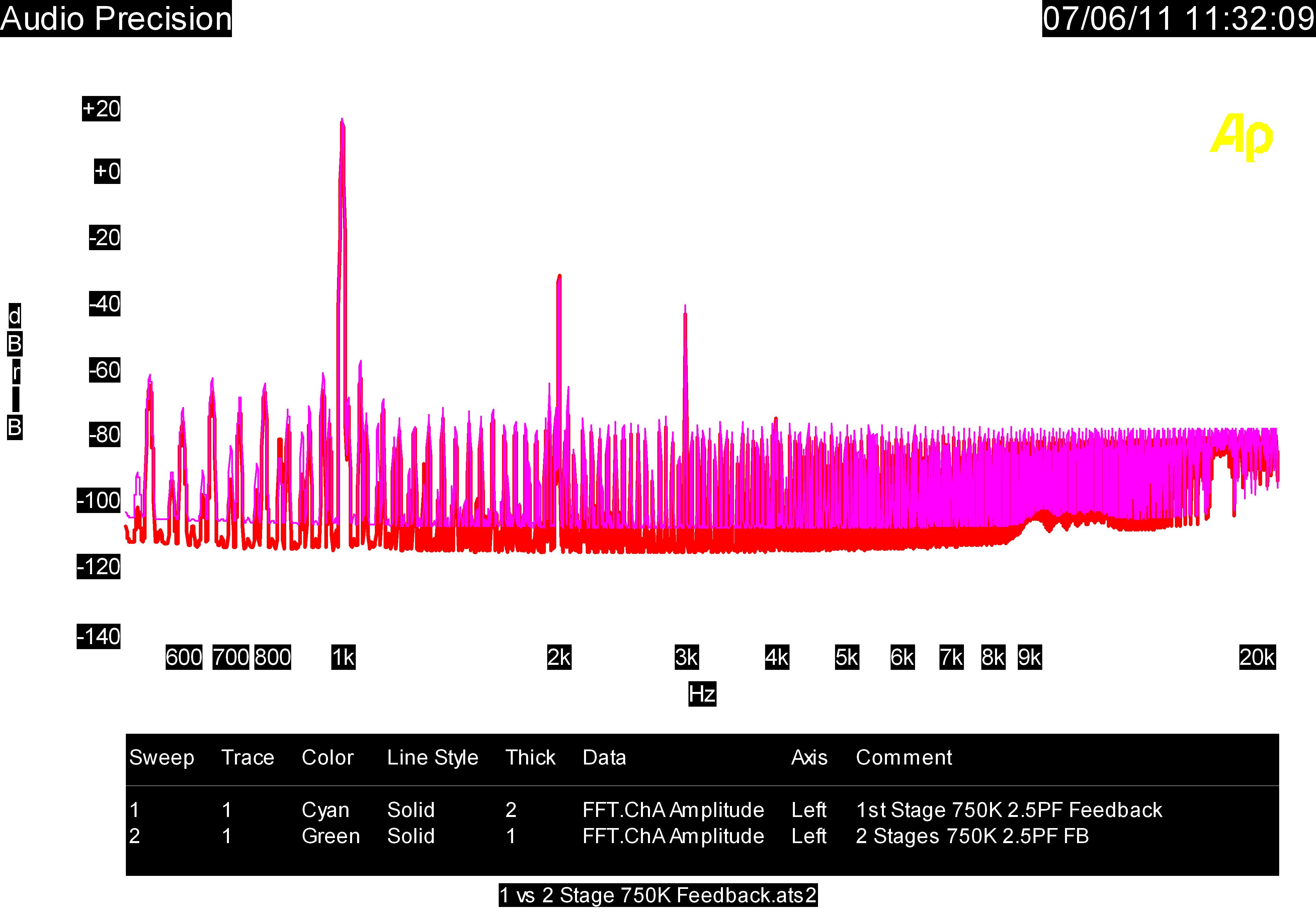

This is the distortion of one stage of my bad triode amps with feedback vs two of the same appended!
More noise, but the increase or lack of it in distortion is interesting. Is this an example of cancellation? I did not go to any lengths to match stage gain. 5% parts were used with grid biased triodes.
Oh the colors are reversed so the labeling makes no sense.

Maybe you can select colors that are even closer to each others so you can test our color separation capabilities as well ! 😀

It gets large enough on my screen (second click) that I can see the only difference is on the 3rd harmonic. If you have any suggestions for color choice before reversal do let me know.
Simon,
With all due respect, may I suggest we spend some time (take it off line) and try to improve your test rig.
It will really help to reduce noise and correctly bias the circuit to allow you to see more clearly what goes on. As I have a little bit of experience and success with tube circuits, I may be able to help.
Past that, your diagram is EXTREMELY hard to read, maybe post two seperate ones, or at least high contrast colours? However, distortion cancellation can be expected whenever even numbers of stages are involved.
