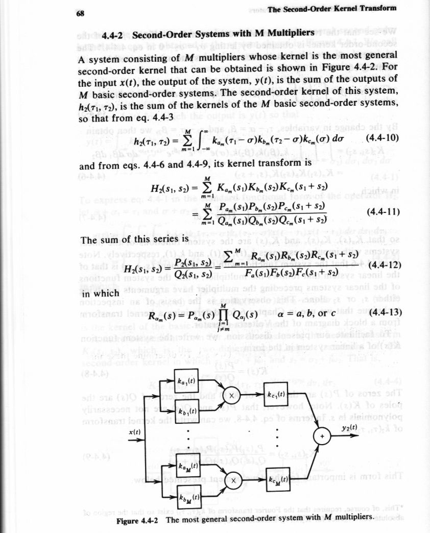

This is probably a waste of time, but...
I sure wish someone (ahem) would get themselves a copy of The Volterra and Wiener Theories of Nonlinear Systems(*) by Martin Schetzen. The Volterra series is an exact description of the input-output relationship for nonlinear time-invariant systems. There are a couple of chapters in the book that discuss the synthesis of the Volterra operators. For example, the first-order Volterra operator is just the convolution integral from linear system theory. The second-order Volterra operator is a double integral that determines the second-order distortion components. Likewise, the third-order Volterra operator is a triple integral that determines the third-order distortion components - and so on to infinitely-high-order operators. This analysis is able to (theoretically at least) determine the exact distortion of nonlinear systems with memory, of which PIM is just one case - provided the system is time-invariant.
The synthesis of the operators consists of finding block diagrams that implement the most general possibilities for each operator. It turns out that these block diagrams contain only three types of elements.
1) Single-input, single-output linear time-invariant (LTI) blocks
2) Ideal two-input analog multipliers
3) Summers
As you might imagine, using the Volterra series for the computation of the output for a given input gets very complicated very fast. But if all you want to do is determine what the frequency components of the output are for the case of, say, an input which is the sum of two sinusoids at frequencies f1 and f2, this is much easier than explicitly computing the exact output. The LTI blocks do not add any frequency components not present at their input, so they can conceptually be replaced by "gain of one" blocks. Once this is done, what you end up with is nothing more than the block diagram of a simple Taylor series input-output relationship that one would use to analyze distortion of a static, memoryless (AM-to-AM) nonlinearity. Hopefully, we all agree that for static nonlinearities, the output frequency components are |n*f1 +/- m*f2|, where n and m are integers. This reduction of the block diagrams for the Volterra operators shows that even for dynamic nonlinearities such as PIM, these frequency components are the exact same as the static-distortion-only case.
Therefore, if distortion frequency components other than |n*f1 +/- m*f2| are present, the system must be non-time-invariant.
Just for grins, I've included a capture of a block diagram of the most general case of second-order Volterra operator. This is for second-order distortion components only, and does not include the convolution integral for computing the "linear part" of the output. Each of the M tandem branches leading into the summer has the same frequency components at its output as its adjacent branch, so for determining the frequency components of the output, there is no loss of generality in setting M=1 here.
(*)Heh heh, he said "Wiener" 🙂
