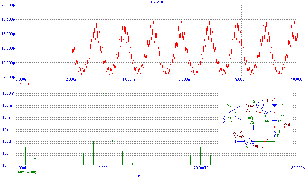

BUT they will have their own frequencies,
NO, NO, and NO they will have the same frequencies. There are people here I assume that are interested in some of the basic principles of engineering. John just ask directly THIS question to Ron Quan and his advisor Tom Lee (an old friend) they will set you straight.
Volterra analysis extends to arbitrary non-linear systems even those with menory. The output with input at f1 and f2 can ONLY be at n*f1+-m*f2. Simple amplifiers do not fall into the non causal non time invariant category.
