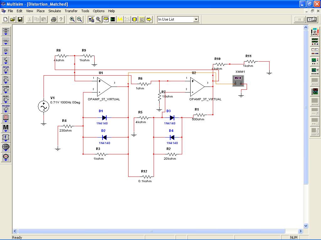

No cancellation intended, I wanted them to have different distortion profiles to show how the interactions create different harmonic structures.
Pavel, This is a tutorial, so the examples need to be very clear. I do not want this to become a "what if you did this with..." When I do the actual hardware I will publish equivalent silly amps, although while set up I just might look at real circuits. ES PS I just got in for repair a one year old mixing console, guess what the op amps are!?
One of these is global feedback, the other cascaded local feedback. Output level is the same.

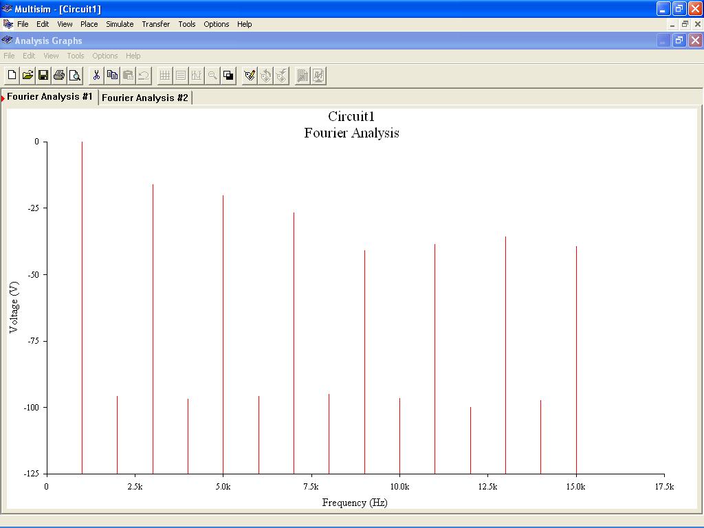

Schematic of high distortion cascaded amplifiers and the results. First is the schematic, second is output from the second amp as shown and third is with the amps positions swapped.
ES
Yes. BTW, no need to convince ME, I already agreed with your view that it makes sense to put the highest gain/ lowest distortion stage first.

Ed, to be honest, your first example is not totally fair because your distortion factor depends on level with those non-linear diodes. Changing the order does change relative levels and thus changes distortion *factors*. So it is not the same as comparing the order of two circuits with different but constant distortion factors.

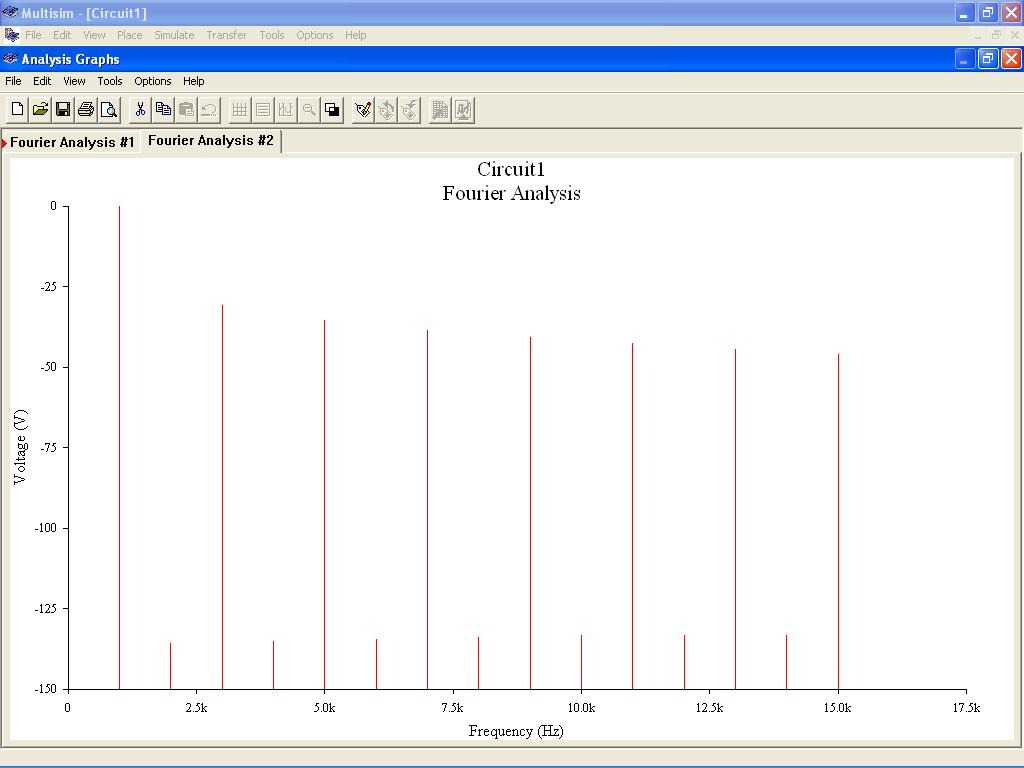

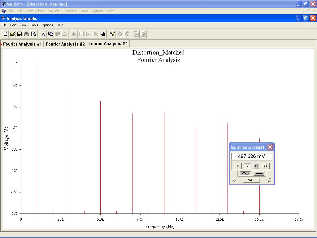

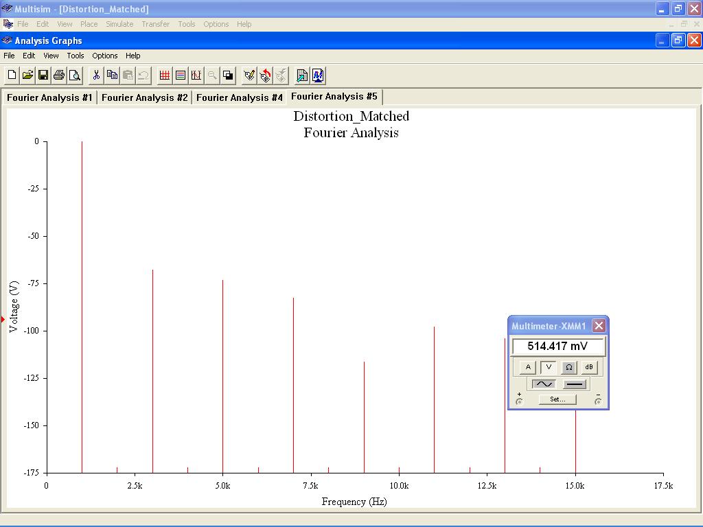

I have cleaned things up a bit. I set the two stages to have a gain of 5. I placed a 5/1 divider on the input and between the stages. I then used stage 1 feeding stage two. I then reversed it and had stage two feed stage one. So both ways the input and output voltage of each stage was the same. I then had stage one drive stage two without the divider but with a global feedback resistor to keep the final output the same.
The results are quite a surprise! Feedback did lower the overall distortion as expected, but less feedback with stage two feeding stage one was clearly the best result!

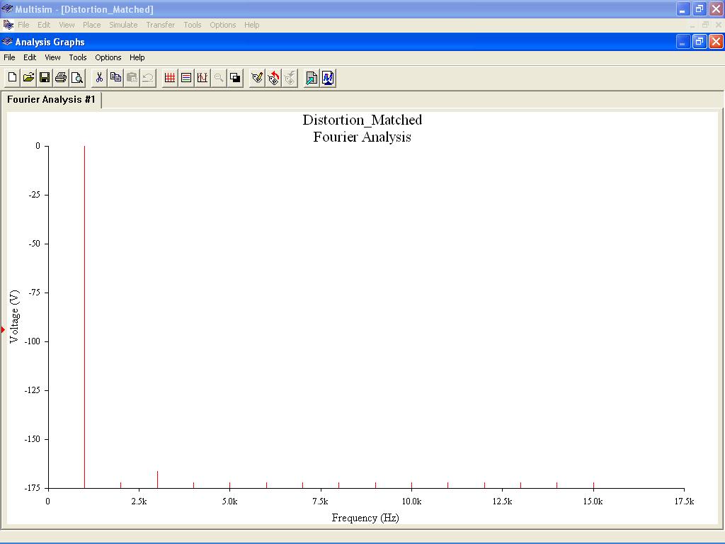

And here is the big surprise. This is amplifier two feeding amplifier one with out the 5 to 1 input pad but with feedback to get the same output.
Yes this is an extreme example, but more global feedback here is worse than less local!

Increasing the gain to 5 might have made the two amps more closely complementary to each other (depends on exactly how you did it), so with the same signal level there will be significant distortion cancellation. This cancellation disappears in the feedback case, as the two amps have very different signal levels. So your results are not surprising. No general conclusions can be drawn from this highly artificial situation. You are not comparing like with like.

Actually I made them more similar to each other and less complimentary. I am pretty sure you know which stage has less distortion now! The issue that popped up seems to be gain hogging in a global feedback situation. One stage gets run until it is very non-linear and the other gets less than it's share of gain.
Also attached is a better gain sharing version of the Two feeding One with feedback. Now Global feedback is an improvement.
BTY thanks for your enforcing the rigor of the experiment.

I think this is important. The only thing global fb does is divide the open loop distortion by the feedback factor. So, you need to look at the ol distortion in each case to decide which you like better in the open loop situation, having in the back of your mind that you can use nfb to lower the cl distortion. Not sure I make myself clear but saying that in some situations nfb gives higher distortion than in some other situations with some local fb involved (or vice versa) doesn't give you a general rule that you can apply.
