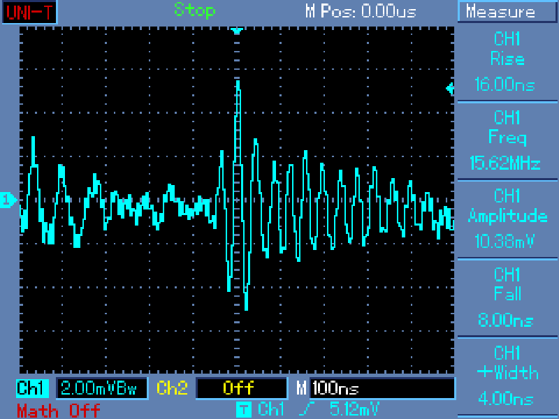

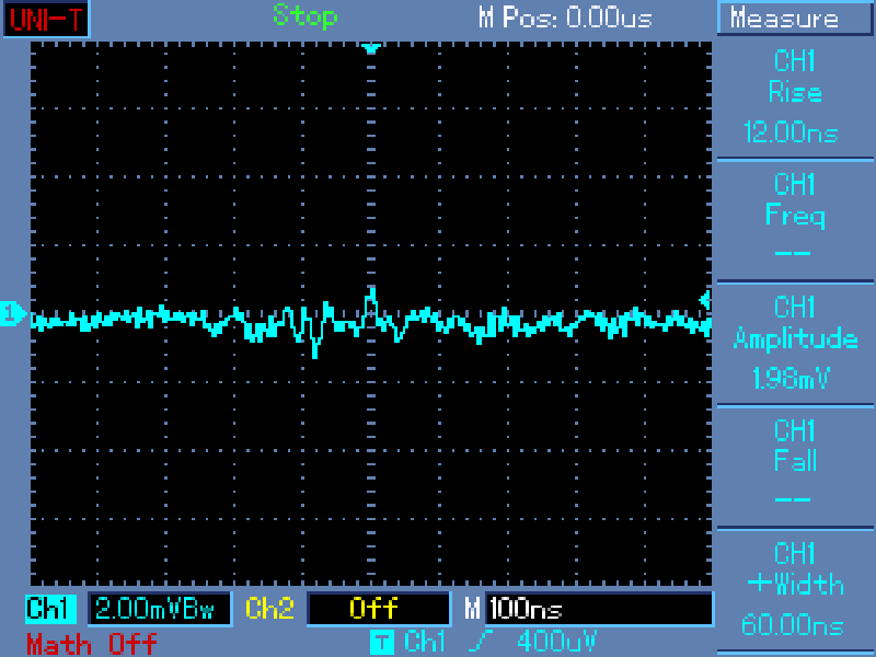

These plots depend only on topology of 2 different preamplifiers. They are measured at analog output, pot at minimum.
15.62MHz is a LED/LCD display driver frequency. All that mess comes through PSU and PSU rails. This is a nowadays reality.
Very true reality! I have just been EMC-qualifying some industrial displays, and can vouch for the difficulty in removing emissions at the frequency of the Dot-Clock [pixel rate] of the HD flat panels. For 1366 x 768, look out for 65-75MHz, radiated, and for 1920 x 1080, ~ 150MHz is very stubborn. The LVDS interface emits badly if there is any asymmetry in the physical interconnect, and the LCD drivers add to the problems.
The CCFL backlights in some of the panels have huge emissions around 100kHz, too - this is too low a frequency for the statutory testing, but not too low to spoil your amplifiers.
Try turning OFF that cheap flat-panel TV while listening, and check for the difference!
Yes, this is indeed ugly stuff. You want to know what it does to an AP system in a lab where theres about 20 TV's running . . . very tough to get clean plots unless you can get into a shielded room. CFL and the new LED lamps also radiote a lot of bad stuff.
Having said that, some ferrites on the input and output of the PSU for conducted noise would probably sort this out, though I know some people believe they affect the sound. Of course, radiated noise is a different matter.
PMA, do you care to share the detials and test set-up with us that gave you these scope plots?
