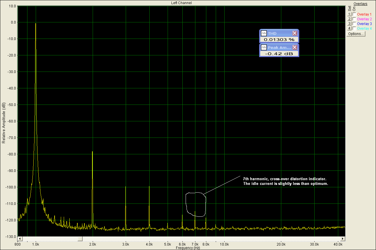

7th harmonic - crossover distortion indicator
I hope John would like to see this measurement. The output stage runs at slightly less idle current than optimum. We can see the 7th harmonic starting to occur.
