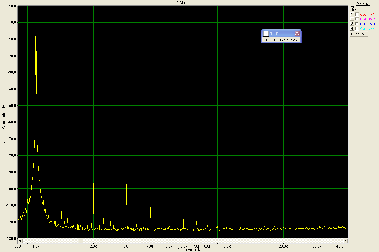

Your topology has smooth decay of harmonic components, with no high order ones, this is very important.
