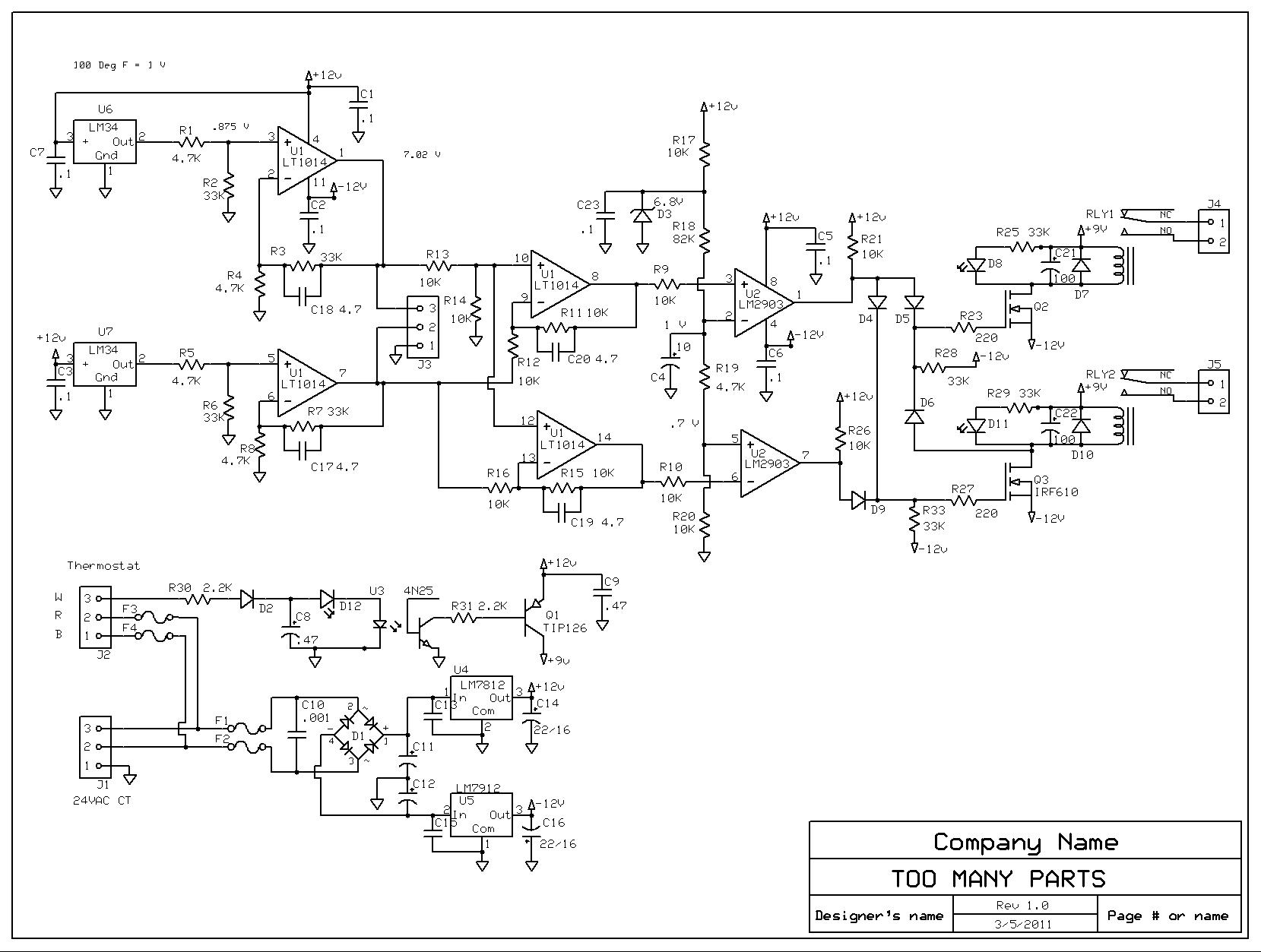

This is what has been keeping me busy. Just got the prototype to work and updated the design and circuit layout.
ES
Well don't hold your tongue Simon, what is it? Not everyone on this board can read a schematic.
I see stereo LM34 Temp sensors, and and 2 relays at the output. So I'm guessing a Thermal protection circuit for an amp. Anything else would be off topic in this forum.
It is of course off topic. I apologize if this has caused you any concern. This is an item John and I discussed. Last year I went through where my energy costs were coming from and reduced my electric bill by 1/2. This was surprising to most here as all of the lighting is already high efficiency. However there was room for more improvement. In the winter the bill remained almost the same.
I showed this circuit as there are a number of good designers who participate and peer review is a good idea.
So from the start, The power supply is almost plain vanilla. A 24 VAC center tapped toroidal transformer (efficiency!) is fused on both legs as there is a center tap and a single fuse would not offer protection. C10 is really a superstition, to reduce EMI noise, who knows if it really does anything. The bridge is 4 x 1N4007 diodes as Mouser was clearing some out for 2 pennies each!. The filter caps into the regulator are both electrolytic (470 uf @ 63 V) and film bypass to prevent any HF instability. 470 uf yields about 100mv of ripple which is low enough the regulators clean it up to a level far better than is actually required. (63 volts because I had them!) I used the 1 amp version of the regulators so no heatsink is required.
The other input is from a U.S. standard thermostat. It should be compatible with anything from a simple mercury switch to fully electronic version. No matter what kind of output it will provide a voltage from 12 to 24 VAC to U3 an optoisolator. D12 is an on board indicator to show when the thermostat is "on." Although there is a common ground through the transformer center tap to maintain possible safety issues the isolator still provides reasonable protection against miss-wiring. Fuses F3 & F4 are actually .2A PTC resistors as mostly fault times are during hookup.
Q1 is a TIP darlington with internal pull up resistors. That gives two diode drops to turn on and plenty of gain. So when this part is active power is supplied to allow the relays to turn on. At DC driving inductors there doesn't seem to be oscillation so no capacitor was used base to collector.
There are two LM34 sensors. These provide 10mv per degree F. I like these better then the C version as there is more signal. As indicated the normal operating temperature is 100 Degrees F, the maximum should be 140. That allows a gain of around seven without worry about reaching the voltage rails. The LT1014 was chosen for low offset voltage. J3 allows remote monitoring of temperatures.
Now the excess parts... the other two sections of the quad opamp do exactly the same thing they subtract one sensed temperature from the other. Both R9 and R10 could go to either. This is a small bit of redundancy since the parts were there. If there is little difference (less than 10 degrees) the lower relay will turn on when called for by the thermostat circuit. If the temperature rises above that then the second relay turns on and the first goes off. If the difference continues to climb then both relays close.
As the relays are 24 volt they run from both rails. R28 and R33 make sure the gate voltage does not exceed the breakdown voltage. The diodes of course provide the switching logic. The comparator is not critical but it needs to be one that has open collector outputs.
Relays are used rather than triacs as they are rated at 30amps 240 VAC. The LEDs of course show the relay operation for diagnostics.
So what this does is when the thermostat calls for it the circuit starts a small blower or pump to allow the heating unit to operate at the temperature where it is most efficient. If the heat transfer is not enough (meaning it is not heating as fast as it can) then a second motor at twice the size is turned on by itself. It that still isn't enough then everything kicks in.
This should reduce costs by keeping the heat source at optimum temperature and using only enough electricity for the motors as required.
The audio use of course would be keeping a system at a constant temperature using a small quiet fan and a bit larger one. Constant temperature being a good thing as it allows the equipment to operate in a stable condition. For small systems a variable speed fan would work. On larger systems variable speed is expensive and lowers power factor.
The circuit can of course be simplified quite a bit. With a slight decrease in accuracy the opamps are just not needed. Running the sensors off the negative rail also will reduce parts count. As built there are no adjustments and all of the units I have built so far work to design goals.
I hope explaining design issues is of some value here.
