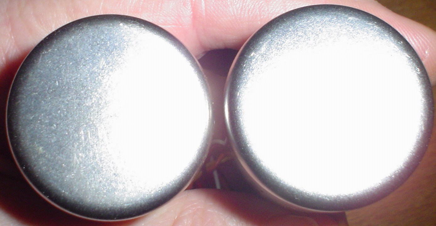

$400-$440 for the transformers we chose.
And that toward a $17000 preamp?
Personally, I find that the playback environment that I normally use in my home listening conditions does NOT need the galvanic isolation of an input transformer, and I generally do not use it.
The benefit of galvanic isolation doesn't really have to do with the playback "environment." You're thinking of common-mode rejection, which is something completely different.
Galvanic isolation addresses issues having to do with interchassis leakage currents.
se
For the LL1931 and 1933?
se

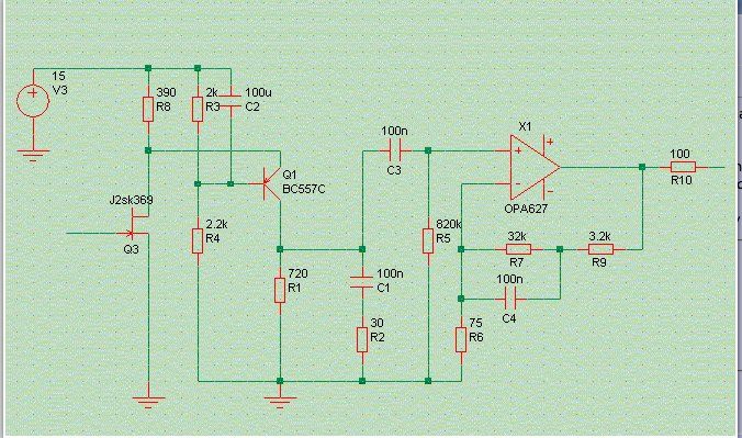

Here is a simple example by Werner that was publshed on DIY Audio before.
2SK369 🙂
One 2SK369 or two paralleled 2SK170 (matched) wont change much. From datasheet, i'd say two K170 are even better (less input capacitance, a bit more transconductance).2SK369 🙂
For DIY, I wouldn't bother to buy K369 when having plenty of K170.
Of course, for commercial adventures/serial production some here are in, using only one part instead of two paralleled, will be the way to go.
Tino

Tino,
regarding capacitance, Crss counts.
Agreed!
K170 has typ. 6pF, K369 has 15pF Crss, so I think paralleling is about the same if not slightly better.
I still have the impression that K369 is a somehow doubled K170.
Tino,
you mean, not a halved K147 ?
(makes me wonder when the hearty DIY orientated start to shave off K369's to add some dissipation surface)
