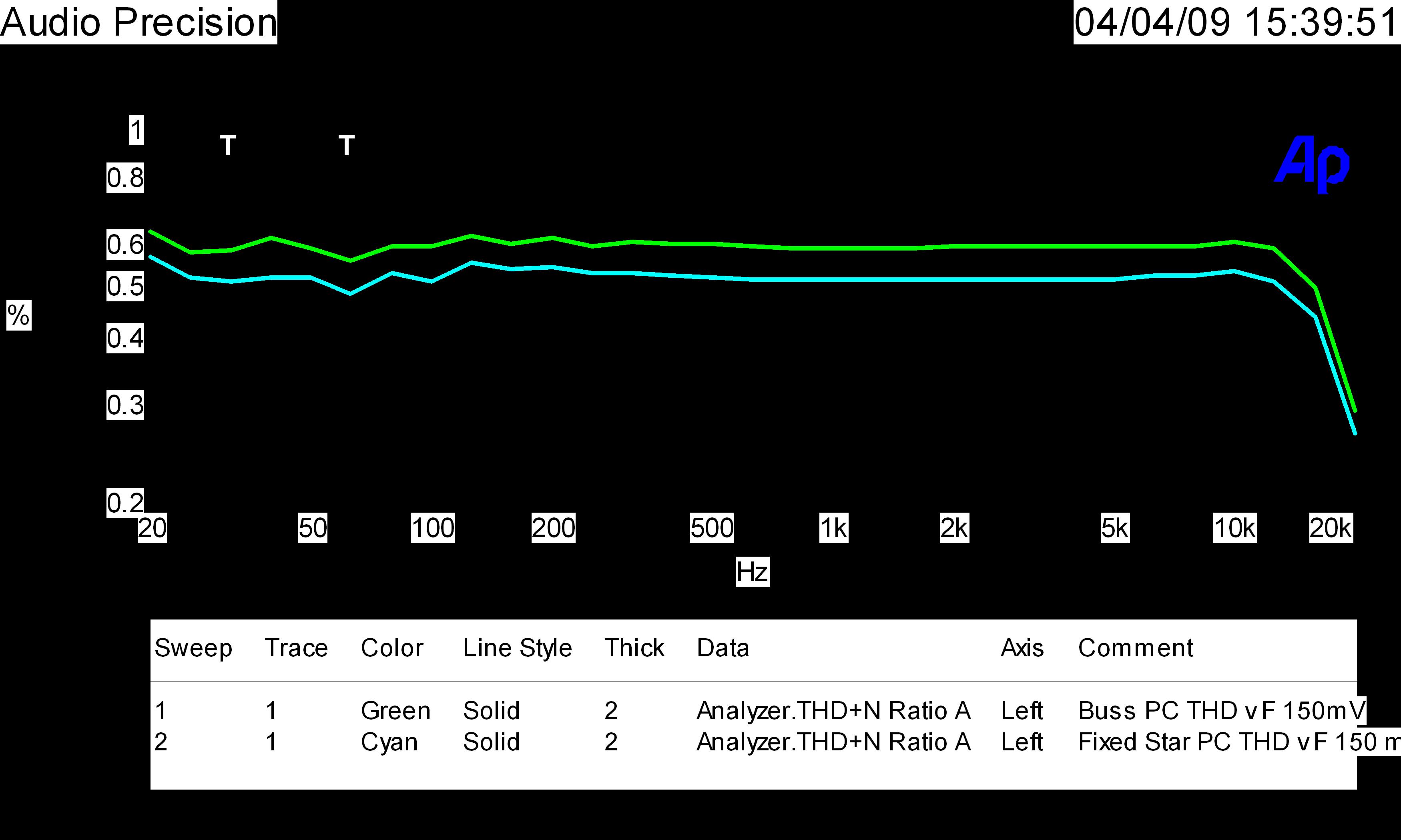

Noise Modulation
Good question; the two mechanisms I am aware of are: conducted RF on shields which is demodulated in input stages, and modulation of DC operating points by ground potential lift inducing currents in chassis and PCB traces.

I'm not following you here. If there's no audible ground current noise when a signal is not present, then how does the presence of a signal cause it to be audible?...
Yeah, but in both of those instances, I don't see that a signal is required. The noise should be there with or without signal.
se
Depends. When your ground gets down and dirty all sorts of nasties happen. You can define them as you want, but here is the picture of the same amp different ground schemes, (One of a series so it is not variation of parameters)
