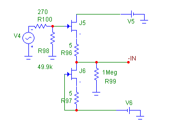

Yes, good idea and works well.

Yes, I learned it from Siliconix in the late '60's. In the early 70's, I designed measurement microphone electronics with it. Later, it became more practical when cost effective DUAL matched jfets came in the same package. Then it became a real advantage to use it, because it could be direct coupled in and out, a real advantage, over my originally preferred design that I I used since 1970, that used a complementary self biasing jfet follower. The complementary design is actually better, but it always has an offset, that is difficult to remove.
