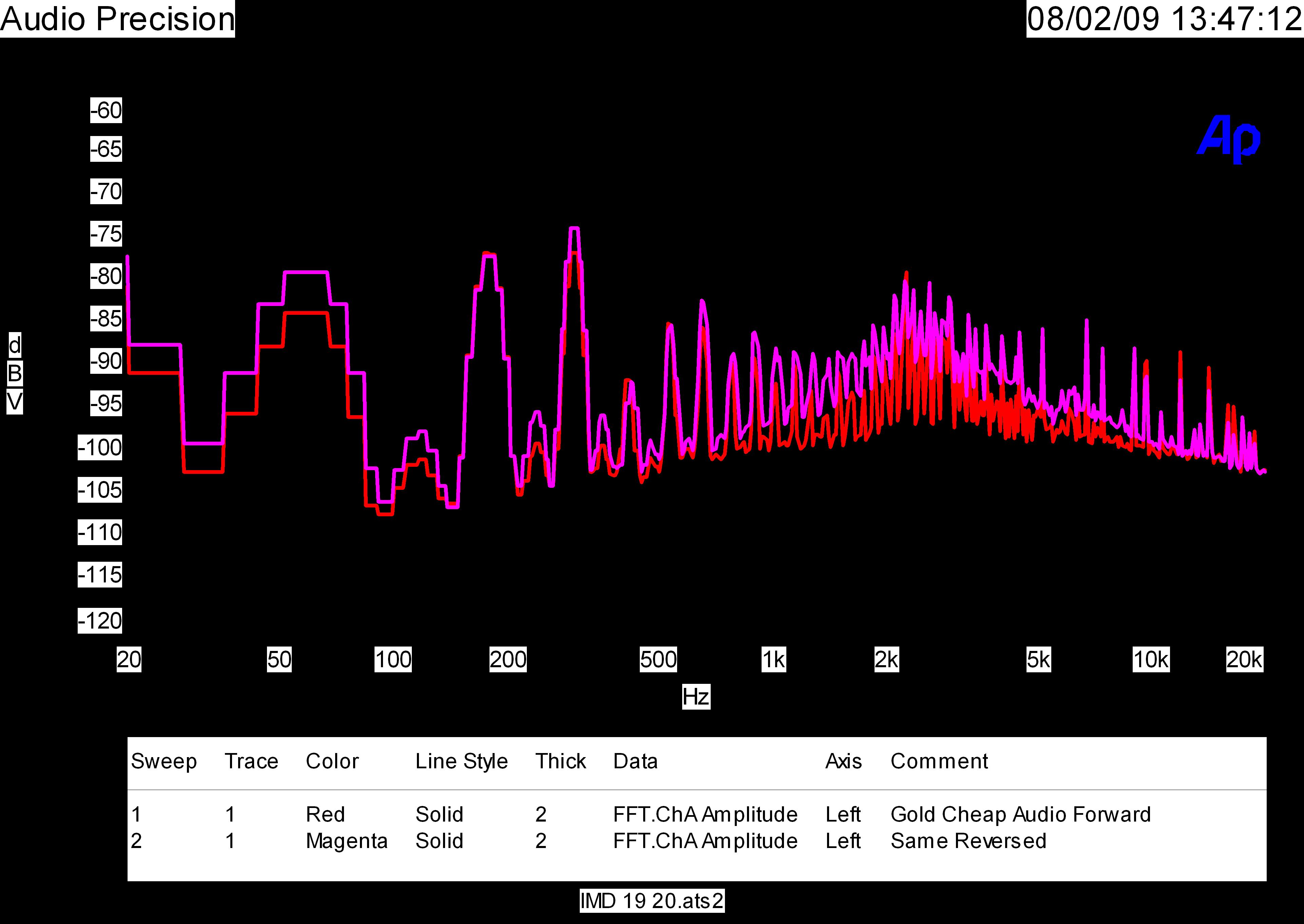

Gross deviation of the sound field at the listening position is a testable hypothesis. After returning to cable directionality we can discuss the -135dB sevenths again, while everyone agrees no stylus ever made has any hope of actually tracking an LP acurately at high frequencies.🙄
Scott,
You've seen this before the IM from 150 mv or so of 93.75 and 96 khz sine waves sourced by 100 ohms and terminated by a high impedance comparison of input to output of an RCA cable with cosmetic gold plated connectors.
The 60 hz noise and harmonics don't really change but the IM does by about 10 db with direction.
Yes it is at a very low level. But it is nicely repeatable.
I've also attached just for no reason a shot of the input current to a 200 wpc class AB amplifier at full output. I just finished mod'ing my bench isolated AC outlet with a built in current monitor. (100mv/A FYI)
Measuring the source impedance of outlets around my place they vary from .085 to .310 ohms. An IEC cord that came with a piece of gear was .185 ohms.
ES

And again I repeat, not one measurement/experiment to explain the results within normal bounds (i.e. defective construction). As you post it here there is virtually no way for anyone to repeat your experiment. The 60hz does look 5dB off and the mess looks like it could include all kinds of lab trash as well.
Without further investigation in such a case of mis-termination I would expect moving the cable 2 or 3 inches in a noisy environment could cause the same effect.

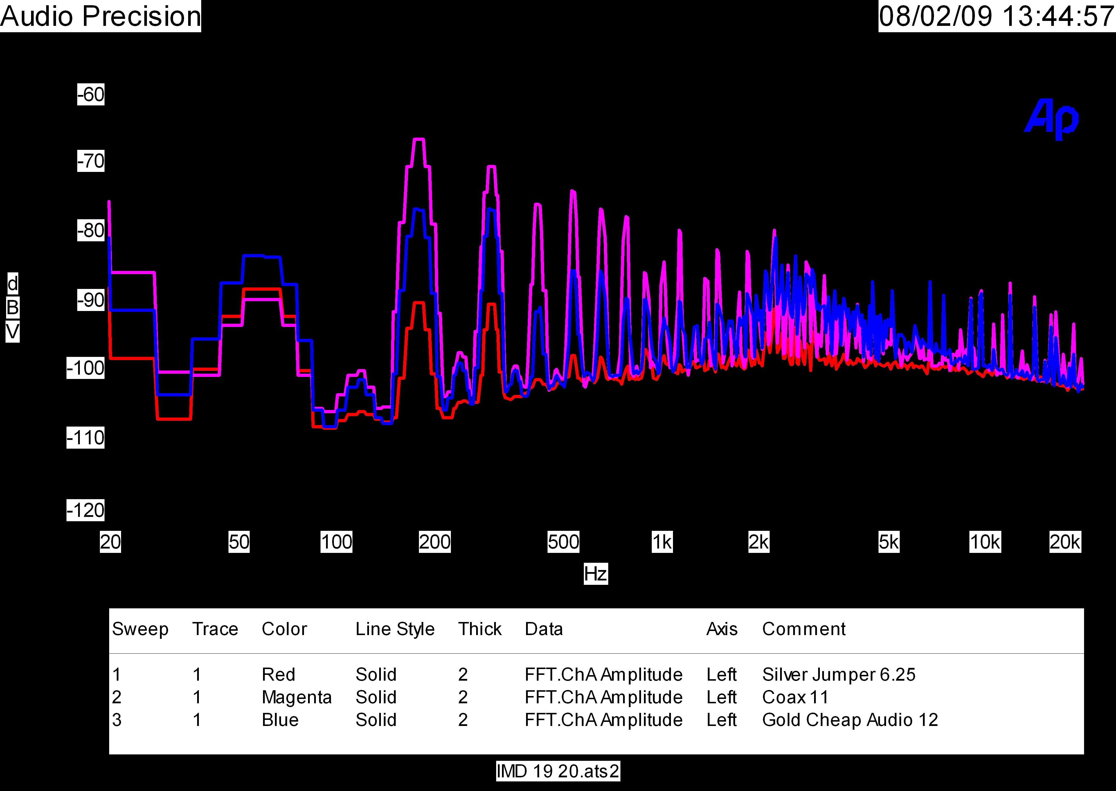

I have attached another image this time of 3 different cables so you can see what changes and what is lab trash.
Any time you want to stop by, let me know. I will eventually get around to improving the instrument and at that time I'll make more than one.
ES

30db at 180Hz looks like a huge difference in shielding/grounding. That has nothing to do with the 96/93.5 input or directionality in the philosophical sense.
Cable Directionality
Yes it is. It has to do with shielding and loop area. The best of that lot was a 6.25 silver wire jumper. The worst was a coil of braided 2m coax.
