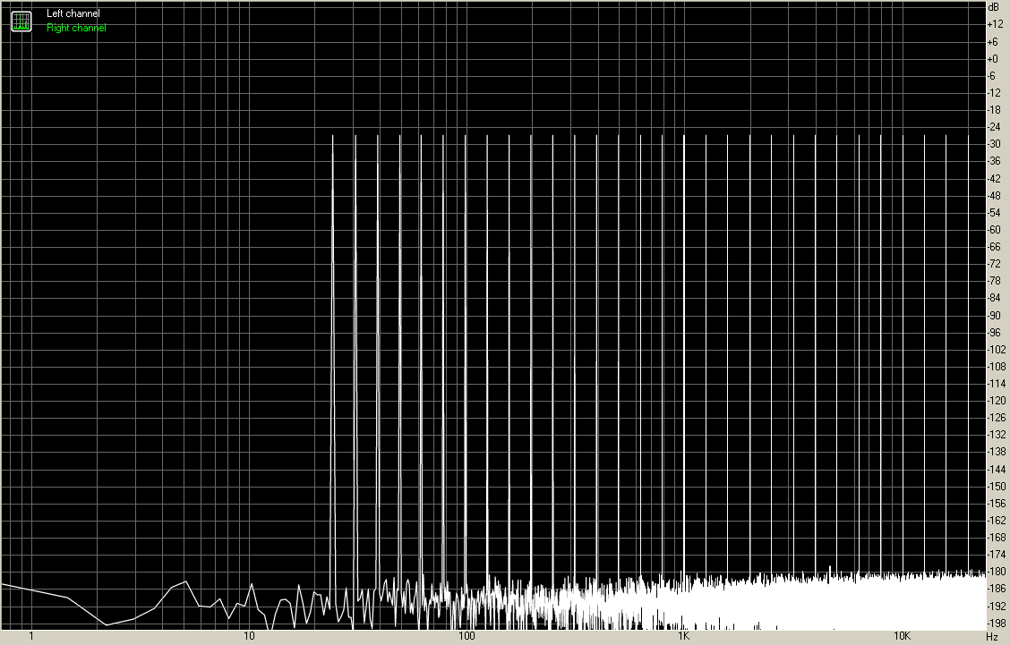

George - Those test files have two versions IIRC one for 64K FFT's and one for an FFT of exactly the sample rate. The later is only useful to those who use one of the comprehensive open source libraries like Octave, PYTHON, etc. The first gives right answers for ONLY 65536 length FFT's which are almost always available on the free tools I see folks use here.
Scott, I quote from your article (Linear Audio Volume 10)
“The files are in 24bit/96kHz stereo.wav format. There are two versions of each, one for 64k FFT’s and one for 96k FFT’s with the intent that with no windowing, individual frequencies and the noise floor can be completely resolved. As a reminder these files only give the desired result at exactly the matching FFT length.”
Attached is the “desired result” for the 64k file done with the free RMAA

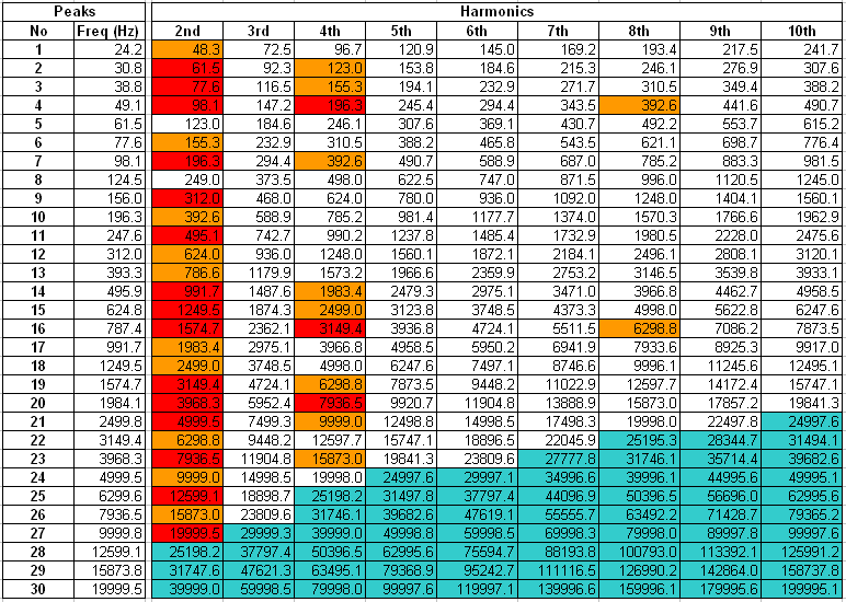

Any kind of nonlinearity products will raise the noise floor.
Only second harmonics and a few of fourths fall on FFT bins and won’t show as increased noise floor.
In red the harmonics that fall dead centre an FFT frequency bin.
In orange the harmonics that fall on the skirts of an FFT frequency bin.
