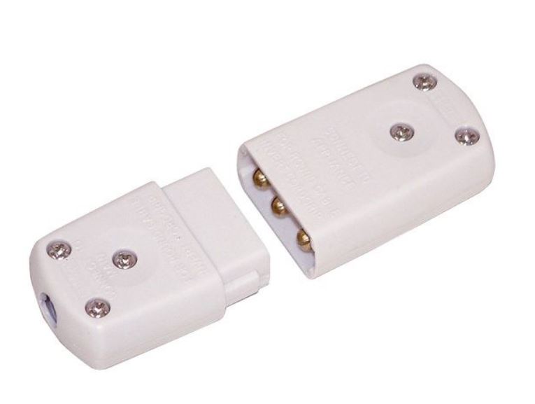

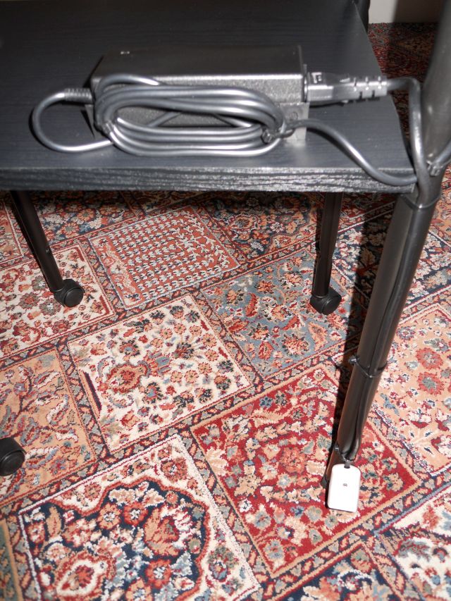

A few days ago I 'hot connected' a laptop brick PSU via a its trailing lead connector (type as shown). I don't make a habit of doing this but have done it many times over the years... heck you have to make the circuit somewhere. It has been in daily use for 6 years but only gets hot connected/disconnected via this plug a few times a year at most.
The lead is correctly wired and has an earth core which carries through to the PSU. The PSU is of a type that has a 3 core lead as standard.
On this occasion there was a very substantial 'soft' yellow flash that seemed to jump a couple of cm from outside the connector at the moment the circuit was made. It startled me, that's for sure. There was a popping sound but not a sharp crack or bang.
Coinciding with this the incoming household 30ma earth leakage breaker tripped plunging everything into darkness. This breaker is on the incoming 100A supply.

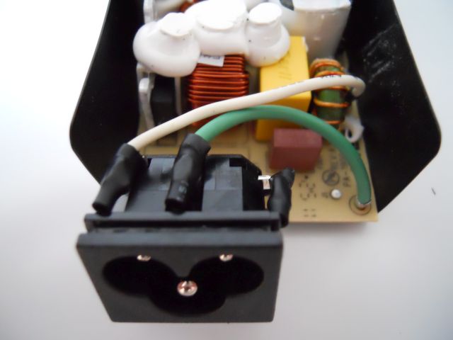

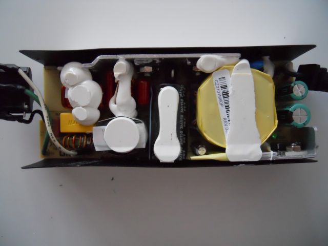

Knowing this could be safety related I opened the PSU expecting to find perhaps a filter cap between line and ground had popped but nothing untoward showed with a visual inspection. There is also no leakage from either line pin to ground.

What is the LNE order of the connecting pins ?.

Dan, the pin order is with E as centre. When the connector is pulled, the 'live' half sits on a (short) woollen carpet but its well vacuumed and non fluffy. The E pin protrudes a couple of mm more than the others so as to make first.

Its just a normal laptop PSU. Just looked again and the reservoir cap is a 100uF/420V radial, so pretty small really.
