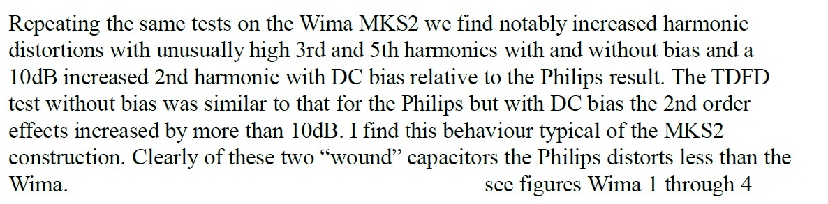

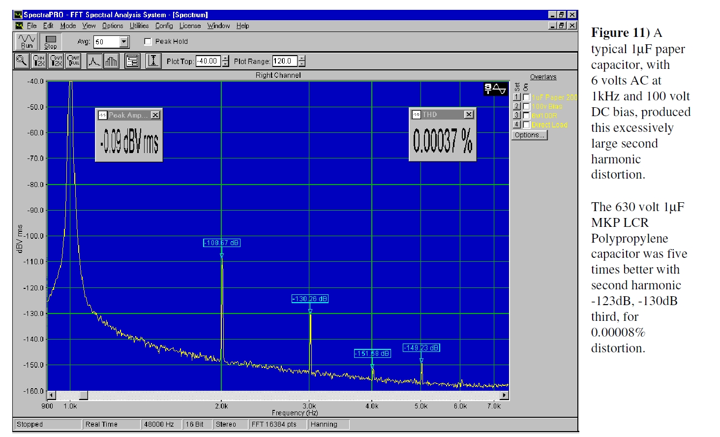

No wonder clogged aged ears prefers MKS, or is it deliberate spread of disinfo?

Ultima, why do you think a paper capacitor might be better than a good MKP? I have seen measurements of boutique caps before, and on the whole, not so very good indeed.
