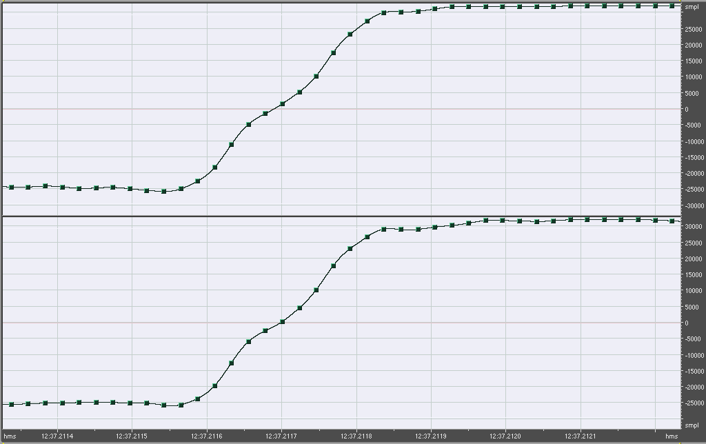

"Low frequency transient" - cannon shot at Telarc 1812 😀. 22.7 microseconds per sample - low frequency 😉
I love the term "low frequency transient" 😉. Especially the fast one.
Like 30Hz transient or so 😀
Kick drums have components in all the listenable bandwidth up to the highest frequencies you can hear.
And even at 30Hz (or the fundamental frequency resonance of the skin where is most of the energy ) the signal is *very unsymmetrical*: A big half of a period during the time the 'Kick' push the skin, followed by a fast decay due to the skin's resonances.
In studios, they use often kick drums opened with only one skin and heavy pillows on it to dump their skin resonances.
Even this first half period 'pulse' is modulated in frequency (not sinusoidal at all) by the decreasing kick speed during the time it pushs the skin, while the signal return to 0 at the skin resonnance frequency.
Is-it a funny English's mistake (Pr Tournesol is not anglo-saxon) to call half a period a "transient" ?
