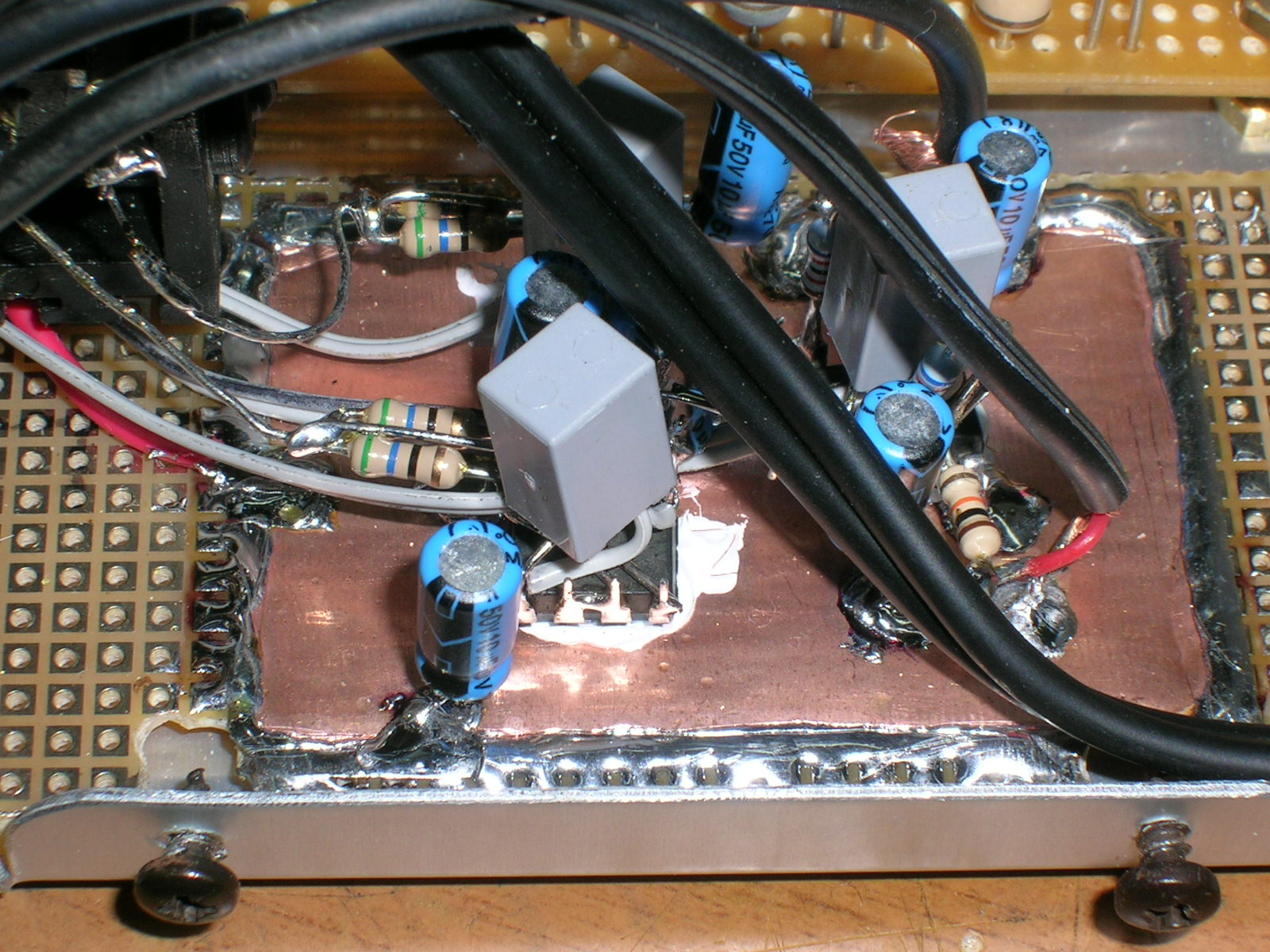

In a small signal application you would have to abuse a little 8-legs by trying to drive a heavy load unnecessarily, for instance, to create a significant rise above ambient. An experiment anyone can try, as long as 741's still have the built in thermal distortion as Solomon showed. Just pop a block of copper on top of the case and see if it changes.

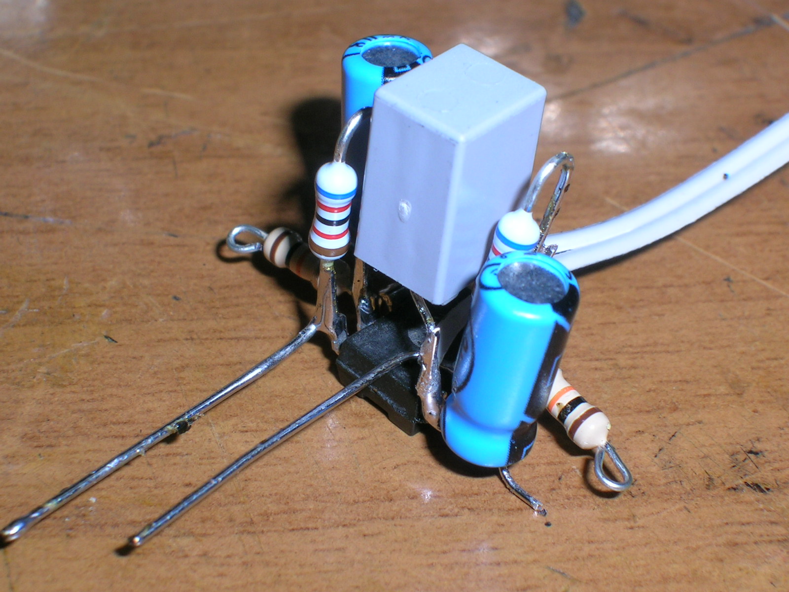

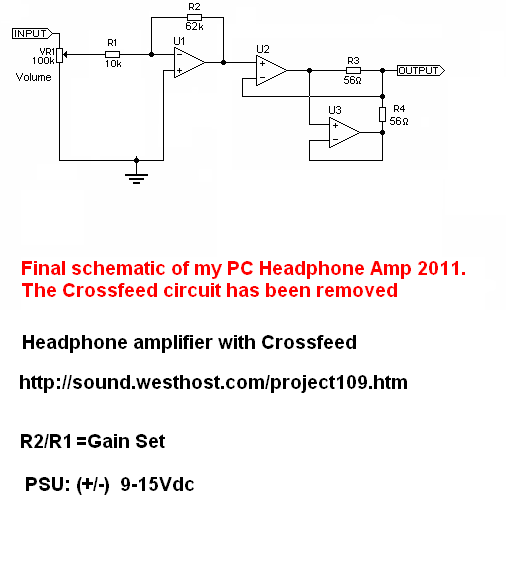

dead bug construction over copper foil, thermo-conductive paste in between
(belt and suspenders approach, just in case 😀 )
